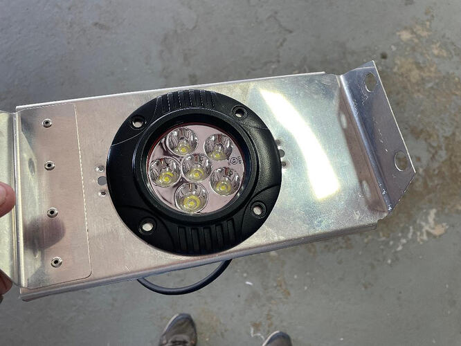

But in the spirit of Mr. Cotton and weight savings I removed those a couple of years ago and installed the ones linked below. They appear to be nearly as bright but have less power draw and save quite a bit of weight. I used the Duckworth brackets to mount them and even trimmed some weight off of the brackets:
Lightronic 3.5" Round Flush-Mount Off-Road LED Pods Light, 6000K Cool-White, Long-Range Spot Beam, Reverse & Backup Light for Jeep, Truck, UTV, ATV, IP68 Waterproof, 12V/24V, 2-Pack - Amazon.com

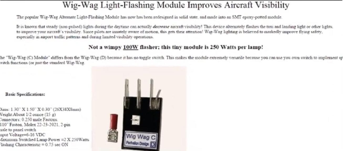

Regarding the wig-wag module, I found one from FlyLED that looks great, which one are you using?

I’ve got one of these:
https://www.amazon.com/ABLE-Sho-Me-Pattern-Strobe-Flasher/dp/B007VS0EDM

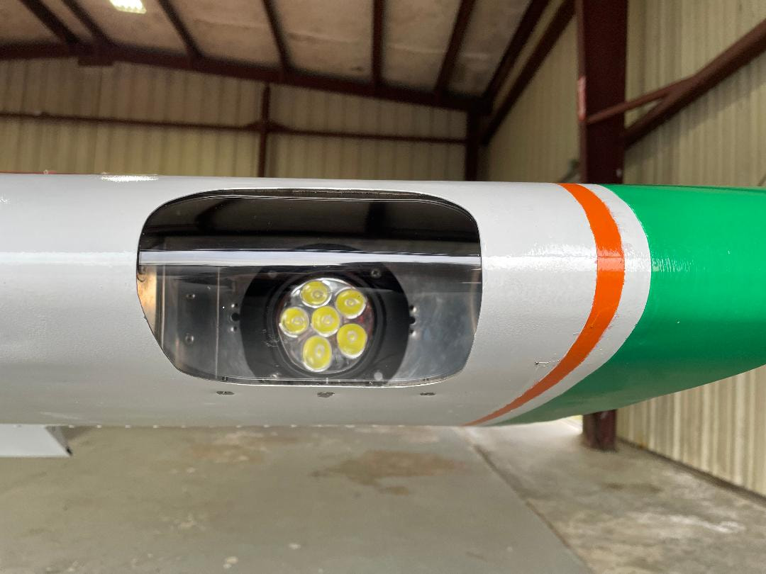

FWIW … here’s a couple of pics I found of the installation of the smaller lights in the Duckworth brackets:
