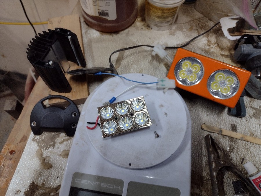

Posted: Wed Feb 08, 2023 11:51 pm
So I had installed a set of fresh aero lights. I bought them from somebody on the forum, and they included the fresh aero Sonex mount kit. The mount kit with the lens and everything is awesome. I really liked the lights, up until the first flight when I found they made horrible noise on the radio. So I did some troubleshooting. I found that in the hangar, I could duplicate the problem. Terminating the shields on my wire did nothing. When I ran the light on a separate battery, the noise went away. Aha! I decided it was conducted noise. So next I put some capacitance out at the lights, like 10 microfarad. It seemed to help, but back in the air the noise was back. So I went and designed a pi filter, basically a capacitor on either side of an inductor. It was still noisy. On a whim I tried my spare hovercraft headlight, it’s like a 36W fog light. No noise from it. One of the tests I did was to transmit on my handheld when listening to the radio, as I found that sometimes my lights were ok in flight until somebody was talking on the radio. I notice there was noise on the handheld. On steady when the fresh aero light was on, and going brrrrt-brrrrt-brrrrt when I had the wig-wag on. So it seems I actually have radiated noise. These lights I bought on Amazon for the hovercraft were actually pretty heavy, until I took off all the extra crap. They have huge extrusions with heat sink fins and for the amount of power actually going to them (.65A at 12V) it’s only 8 watts. I think the huge extrusion is for looks and weather protection. I stripped off all the crap and what was left over weighed about 0.05 lbs. The old lights were 0.576 lbs each so I’ll save about one lb.

pretty much what I did. i dont have noise, so I wonder about the controller box that operated the wigwag/landing selection. yours might be solid state. I used relays and caps…no microprossor control at all, and treated both incomming and outgoing voltage points with filter caps, and my circuitry is inside a tight aluminum box. I also mounted red and green leds I can view when lights are in use, one led for left and one for right lights. . Any idea of the actual waveshape, frequency of the noise? the other thing I did was to mount the heat sink originally used, after removing the ‘crap’ as you have done, directly to the main spar front side, and of course used liberal ammounts of white heatsink grease, which keeps out moisture also. as I write this, I wonder if the led elements themselves are at fault?

as a total asside, the old lights I had are the same as yours in the picture. I have some spare LI batteries, so I just made some ‘flood light’ type flash lights out of them, for general allumuniation when working on other non avaition things(did I say that??).. made a couple of chargers for the batteries too.

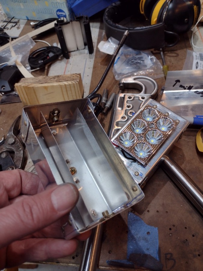

Here are my new mounts/heat sinks. 0.25 lbs for the two lights. I still need to add the molex connector.
With no heat sink the light got too hot to touch very quickly. I ran one light for 45 minutes and it was just a little warm. I used heat sink compound between the circuit board and my new part. It’s pretty much all .016 except the additional heat sink on the second one is made out of flashing, which is .010.

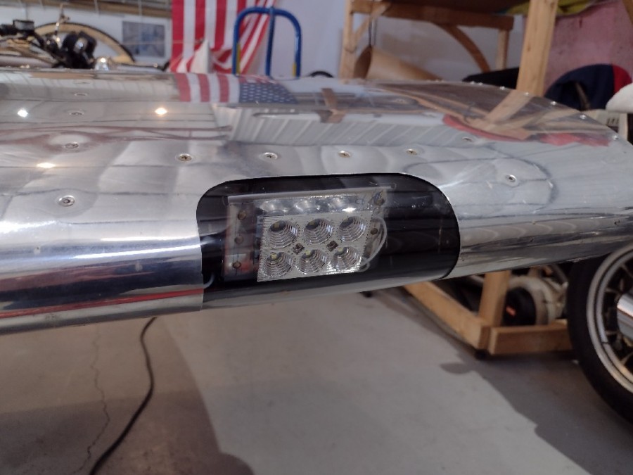

Posted: Sun Feb 19, 2023 1:34 pm
Here is my final installation. For the weight and budget conscious Sonex builder this is the way to go. Cheap LED lights mounted to a thin aluminum box for mounting and heat rejection.
No radio noise. Now I can wig-wag in the pattern.
