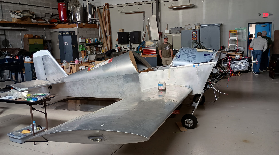

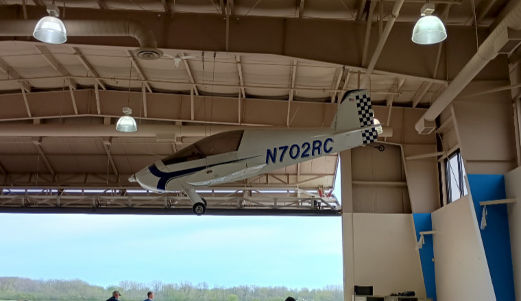

This poor Sonex will never fly again. They drilled holes through the spars to hang it up. Looks cool though.

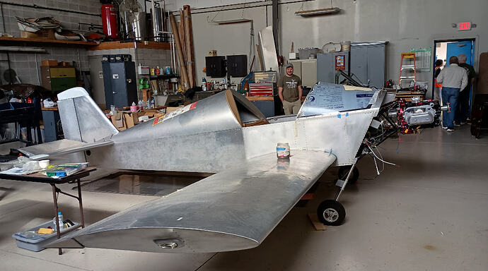

Chapter project, donated by a deceased member. Sadly his wife doesn’t want it to fly, so it’s just a hobby project for the chapter.
Very cool facility.

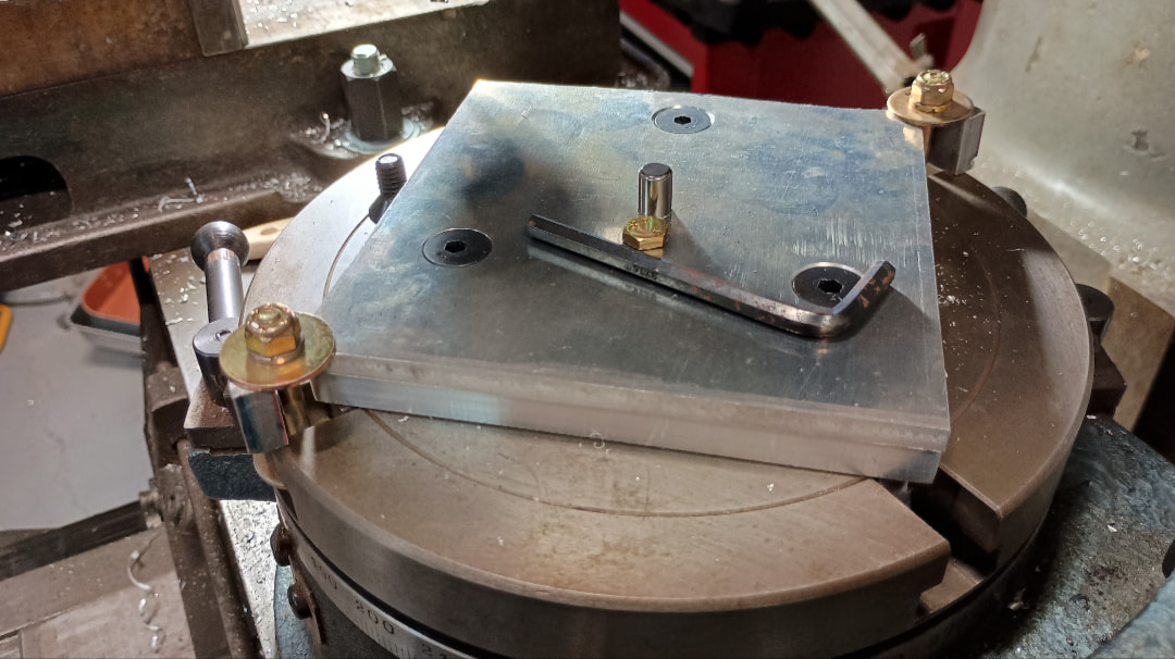

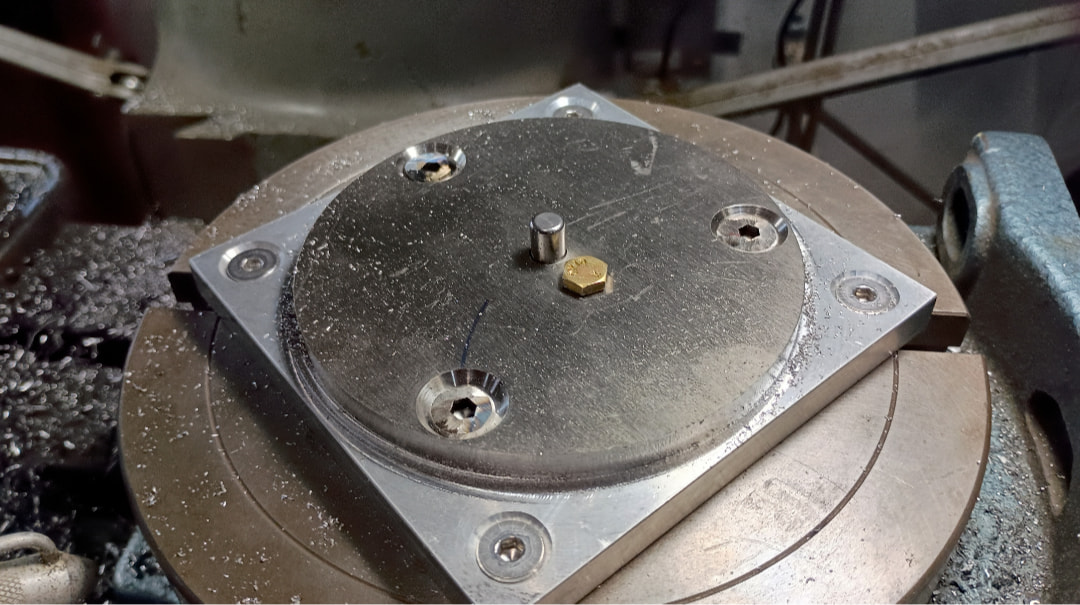

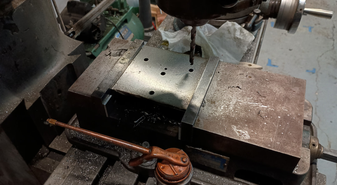

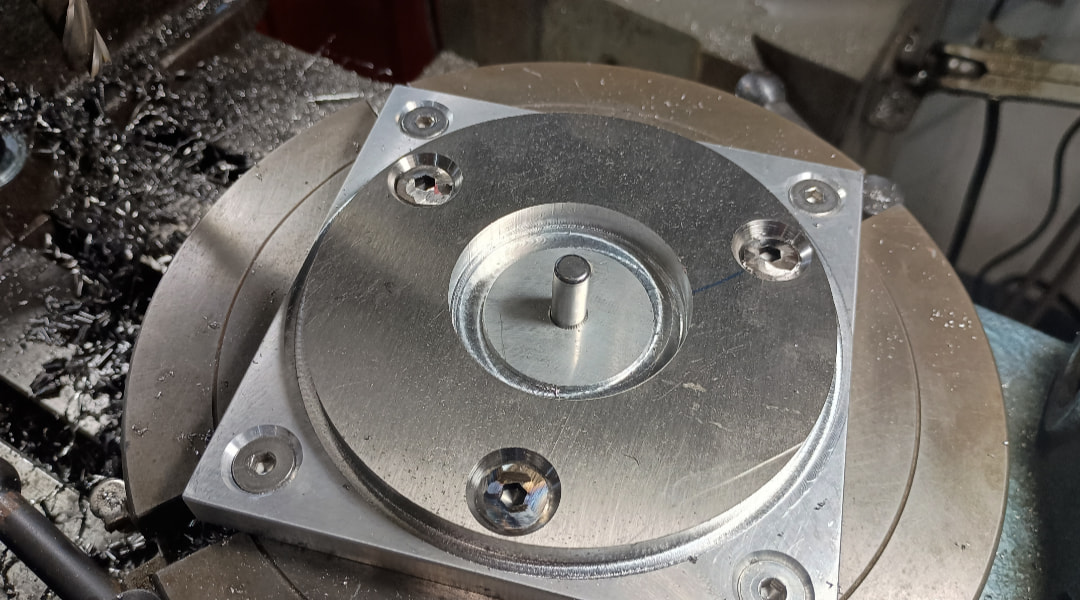

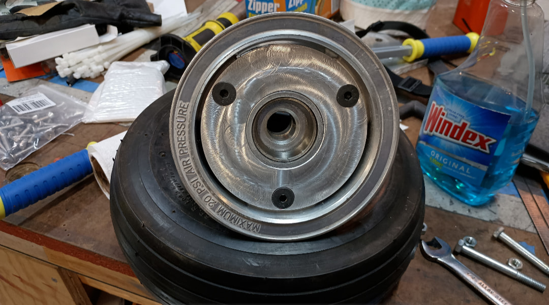

As documented elsewhere I made brake pucks when it seemed bleak for Sonex. I had also tooled up to make rotors. I am going to make a few for personal use, partly because it’s a great learning experience, and I have a goal to make titanium rotors to save about 0.7 lbs for the pair. First I made one out of aluminum, just for practice. Here’s a blank with holes drilled and screwed down.

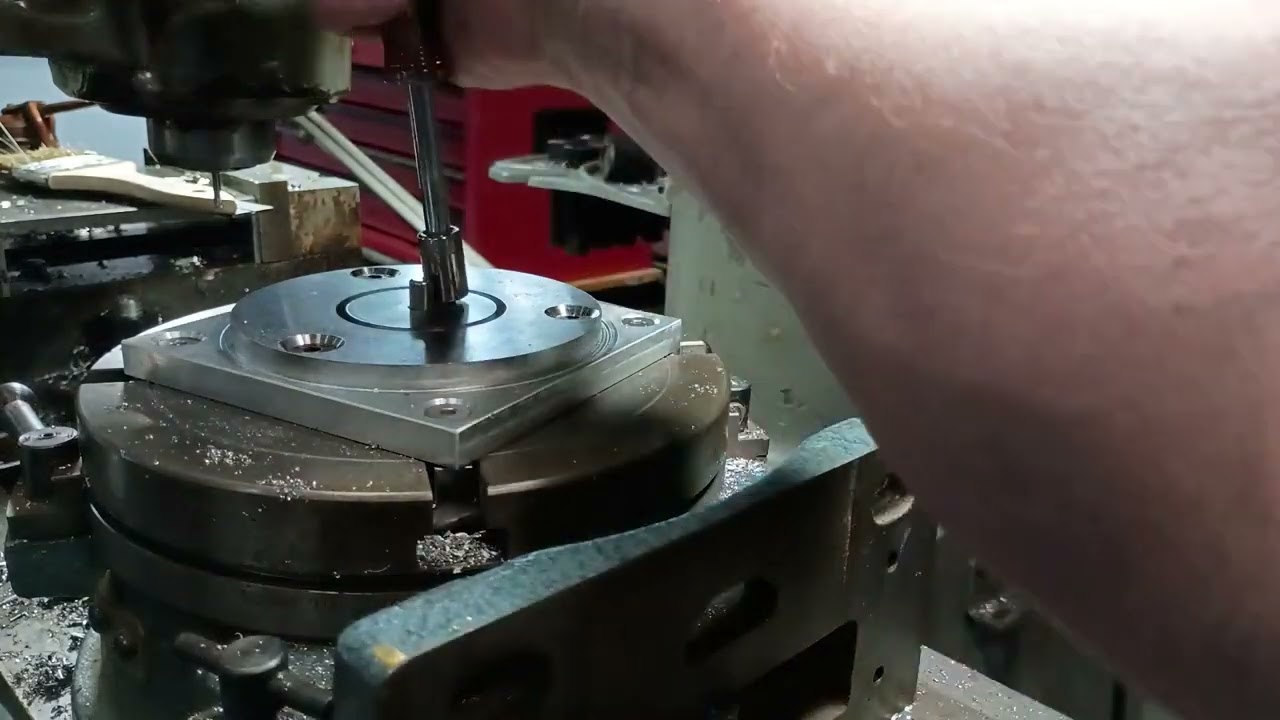

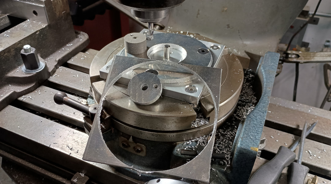

Circles cut using the rotary table:

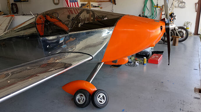

Trial fit on one of the spare wheels I just got:
The ones from Sonex are a bargain! Lots of work and expense to get this far.

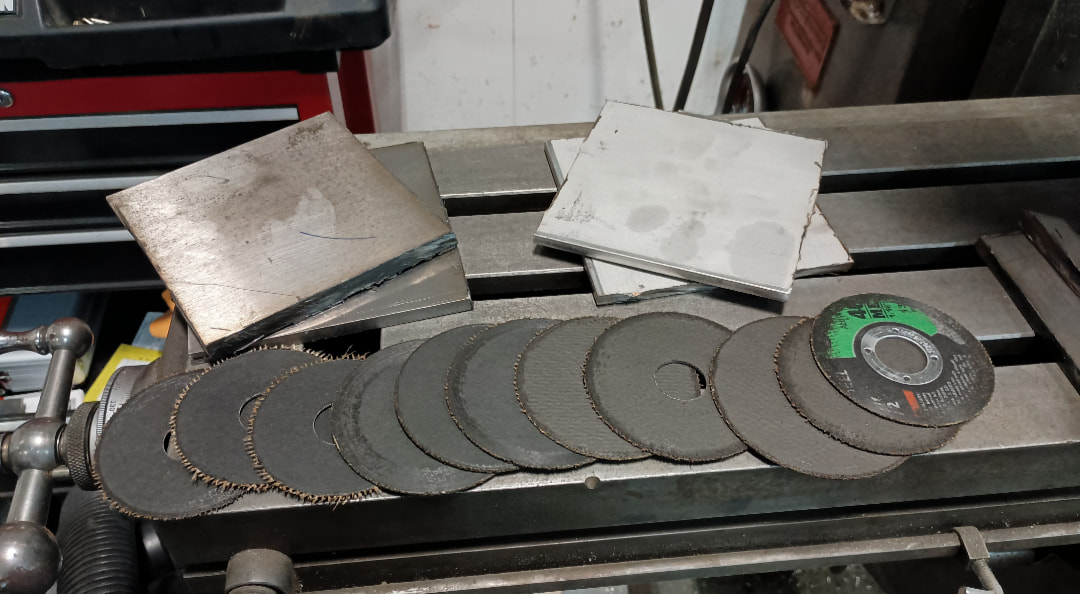

That looks great! I assume the pictures show the aluminum test piece. Did you already buy the titanium stock?
Titanium blanks on the left, stainless on the right. I need to try the plasma cutter on this stuff. Took a couple weeks to get the burned cutoff wheel smell off of my hands.
The prior pictures were the aluminum practice piece.
