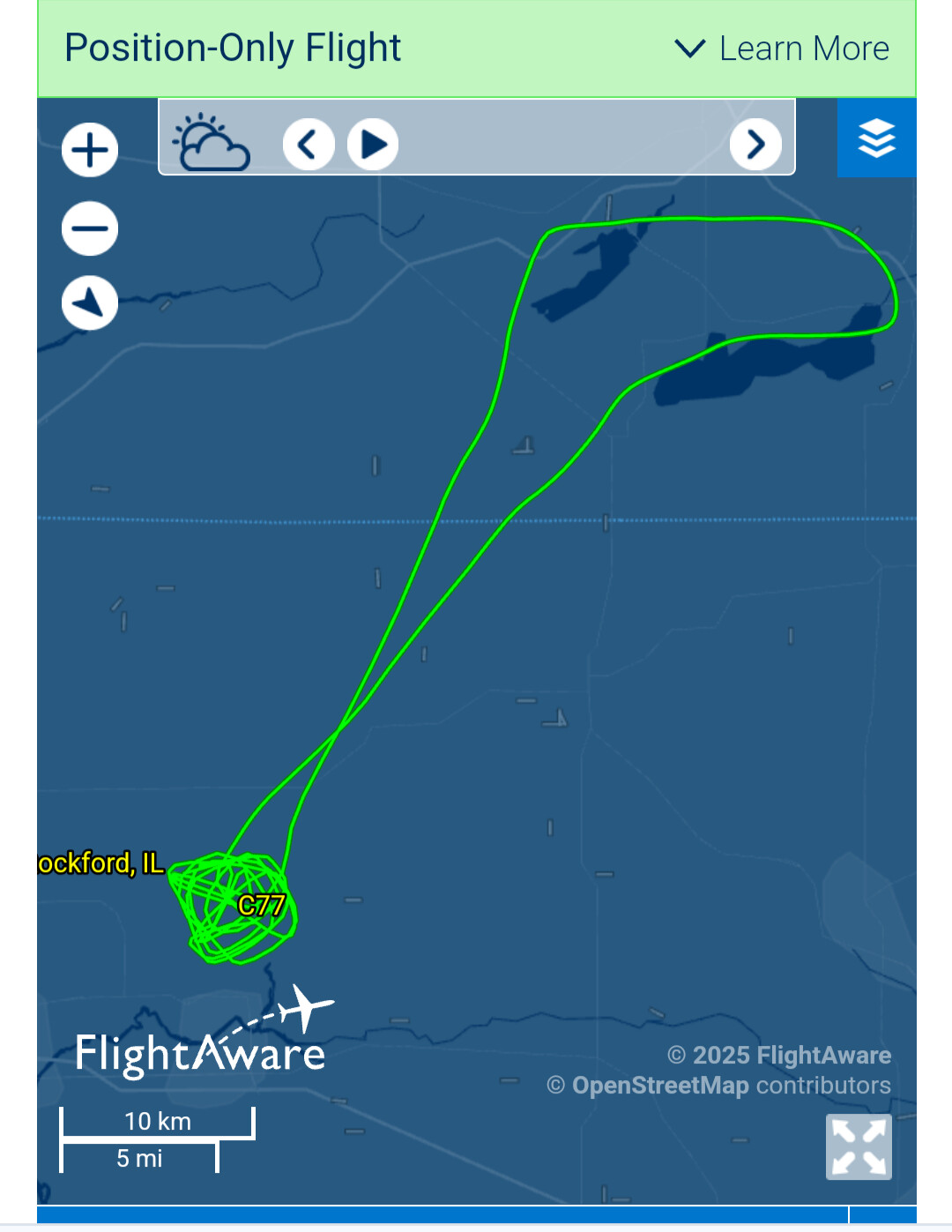

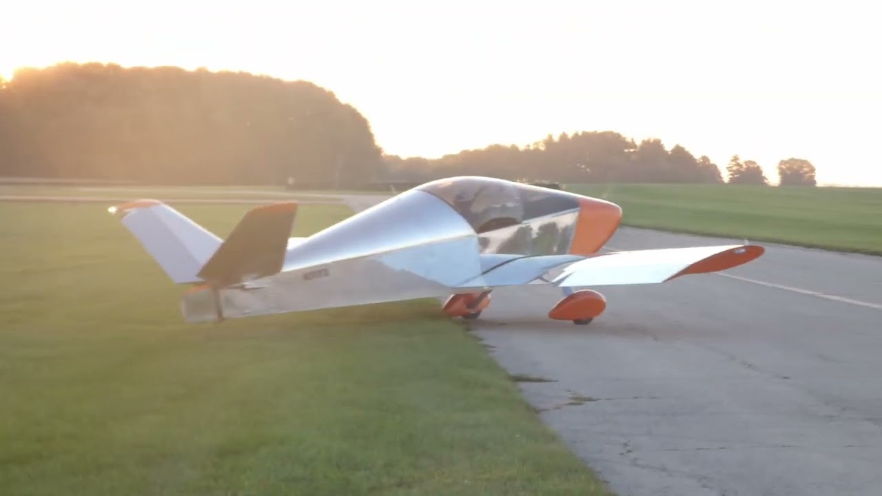

We have been down for maintenance since May. Worked through some oil temperature and pressure issues and did our first 2-up flight over the airport. Shortly after this picture was taken, voltage went over 15. The EarthX battery isolated itself and a total electrical failure ensued.
Did you figure out why the voltage went up?
Yep - discovered the bolt on the negative battery terminal was missing. It must be out in the countryside somewhere.
