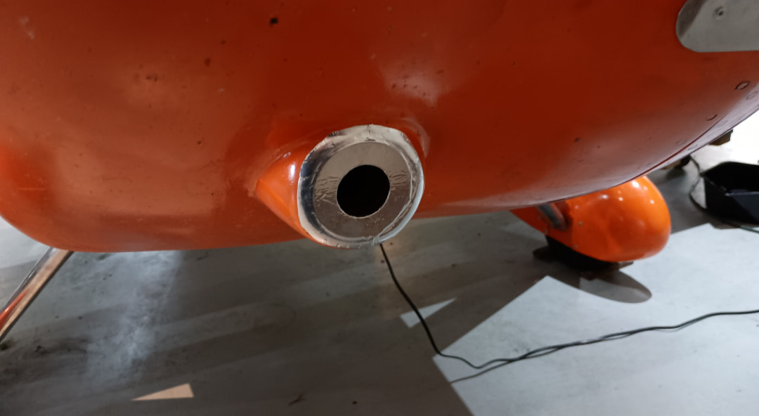

I’m actually thinking the issues I had with rough running may have been a combination of really cold weather, like around 0F on the ground, and my fresh air induction. I was working on choking down the inlet when I stopped to rebuild the heads. I was propping my neighbor’s Luscombe last week and noticed part of his winterization kit includes a blocker for the air filter. I’ll have to get a picture of it. I went through my records and never flew in serious cold with the fresh air induction until last December.
It was still missing the first flight this morning. Then I added this blockoff:
It got better. So I blocked it all the way off, removed the scat ducting, and flew again. I lost about 100 rpm in climb, but the engine was happy. I’m thinking it needs to be above 40 or 50 to get outside air. I don’t think the 100LL is vaporizing well.
