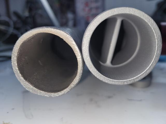

The VeeCU fully addresses balancing fuel distribution so there is no need to extend the port divider as was done on the prototype intakes. Extending the divider reduces the cross-sectional area by a factor of two and reduced static runup by about 80 RPM.

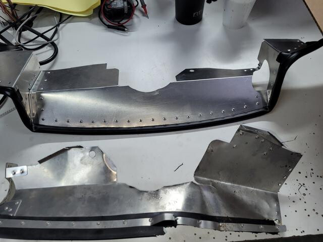

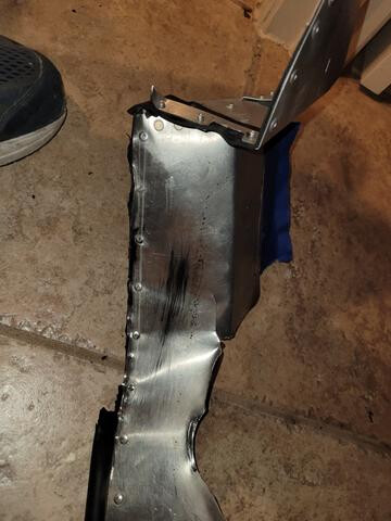

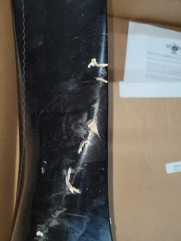

While testing/comparing the intakes I had to remove and reinstall the baffling. During one test I left the front piece in place without the side pieces installed. Anyone familiar with Sonex baffling knows that without the sides installed there is nothing holding the front lip in place. Well, I neglected that fact and decided to do one more full static runup before changing intakes. A minor catastrophe ensued. Baffling destroyed. Luckily the prop bolts did the bulk of the damage, but the prop was scratched up.
I rebuilt the baffling and sealed the scratches with epoxy.

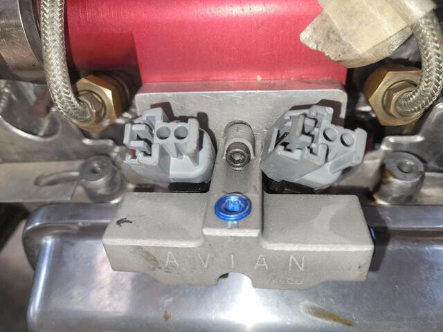

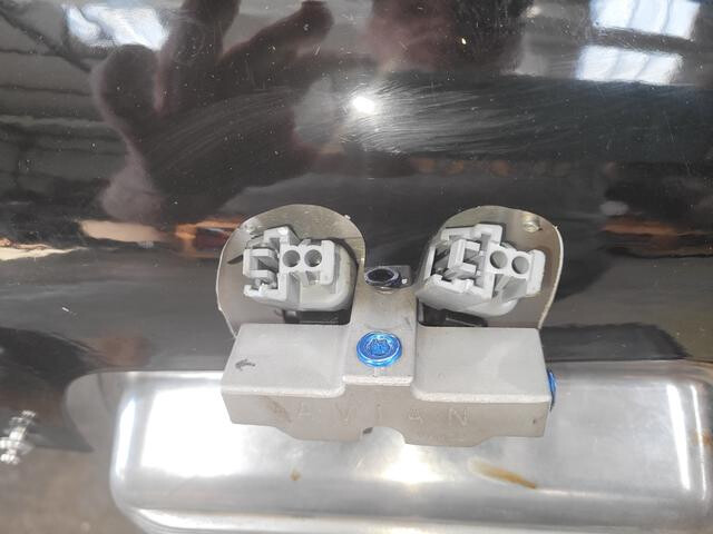

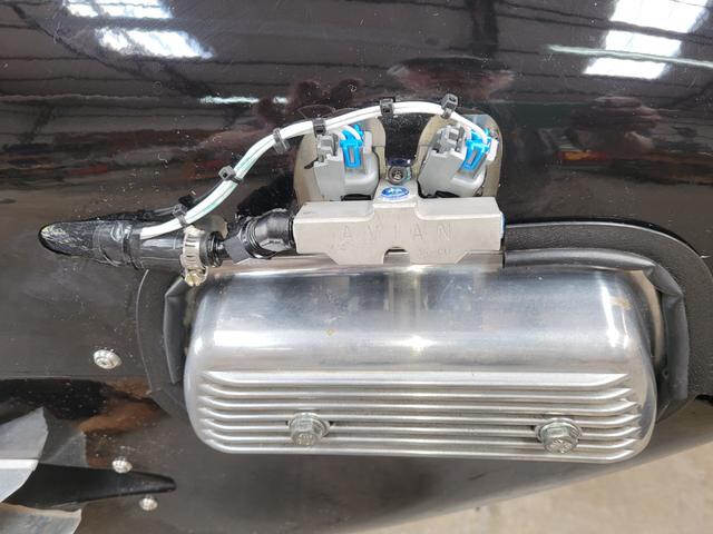

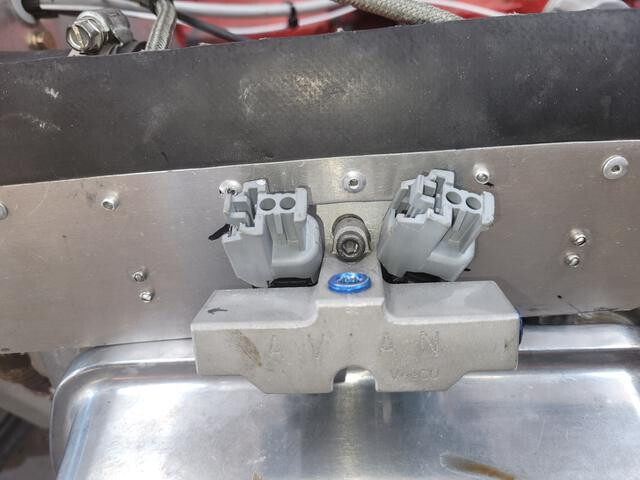

To avoid the delay of another design/procurement cycle, I decided to adapt the Sonex logs I have to accept the fuel rail provided with the prototype intakes. The Sonex logs and the GPAS logs provide virtually identical static RPM.

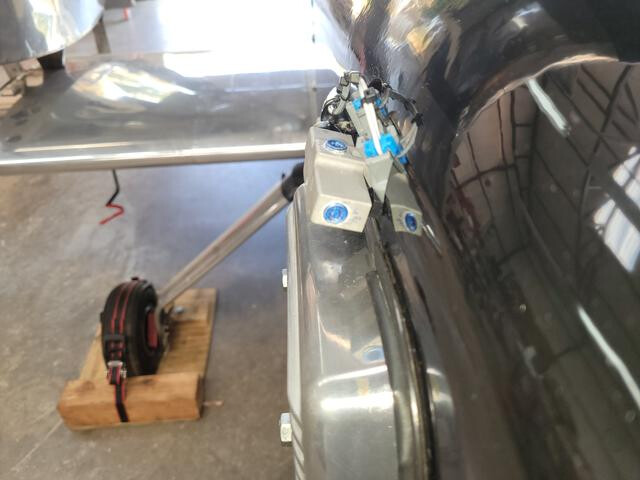

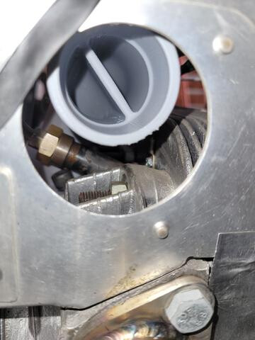

The baffling has been modified with a cutout for the injector assy.
Cutouts were made in the cowl allowing for engine wiggle room.
BTW, the holes in the prototype rail had to be tapped 1/8" NPT. Whatever material the rails were printed from, it’s allergic to a tap. It took four hours of tap the holes to adequate depth.
There will be more cowl surgery to get the fuel to the rail. I have some fittings “Out for Delivery”. Can’t wait to run the system on my Onex.

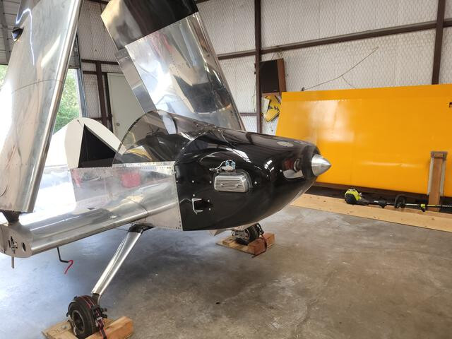

Hi Guys,
Well finally, it’s alive!!
I’ll run to the airport for a load of fuel in the morning so I can tune the engine. Hopefully I’ll get the airplane back to the airport Sunday and start testing.
The first flights will be with the VeeCU providing secondary ignition and the AeroInjector providing fuel. That to verify the AeroInjector tune and idle. I will also switch fuel pumps (etc.) on and off in flight as an abbreviated Electromagnetic Compatibility test. If the light on the VeeCU illuminates that indicates a reset. I don’t expect any problems.
After I’m sure the AeroInjector is well tuned, I’ll fly the pattern and, abeam my touchdown point, I’ll switch to EFI.
Then …, test, test, and test some more.
The installation would have been much neater if I had a two place. :wink:

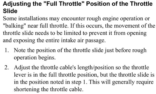

I spent a couple of days working with the AeroInjector. I thought I had it tuned but on the first test flight I ran into this:
I tried to tune around it but to no avail. So, in the end I had to limit the slide movement at full throttle.

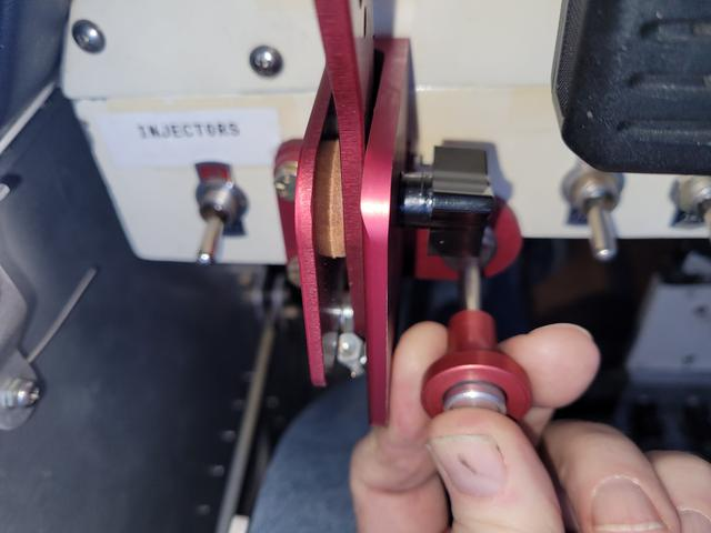

BTW, someone needs to explain how, on a pull to open throttle, stopping the movement short of full throttle is accomplished by shortening the throttle cable:confused:
I didn’t measure the distance between the throttle quadrant and the mixture cable. I assumed my pointer would fit between the cable and the quadrant. I was wrong. That makes switching from AeroInjector to EFI fueling awkward. The good news is that the switch from EFI to AeroInjector fueling only requires a thumb to press the mixture. Very easy.
