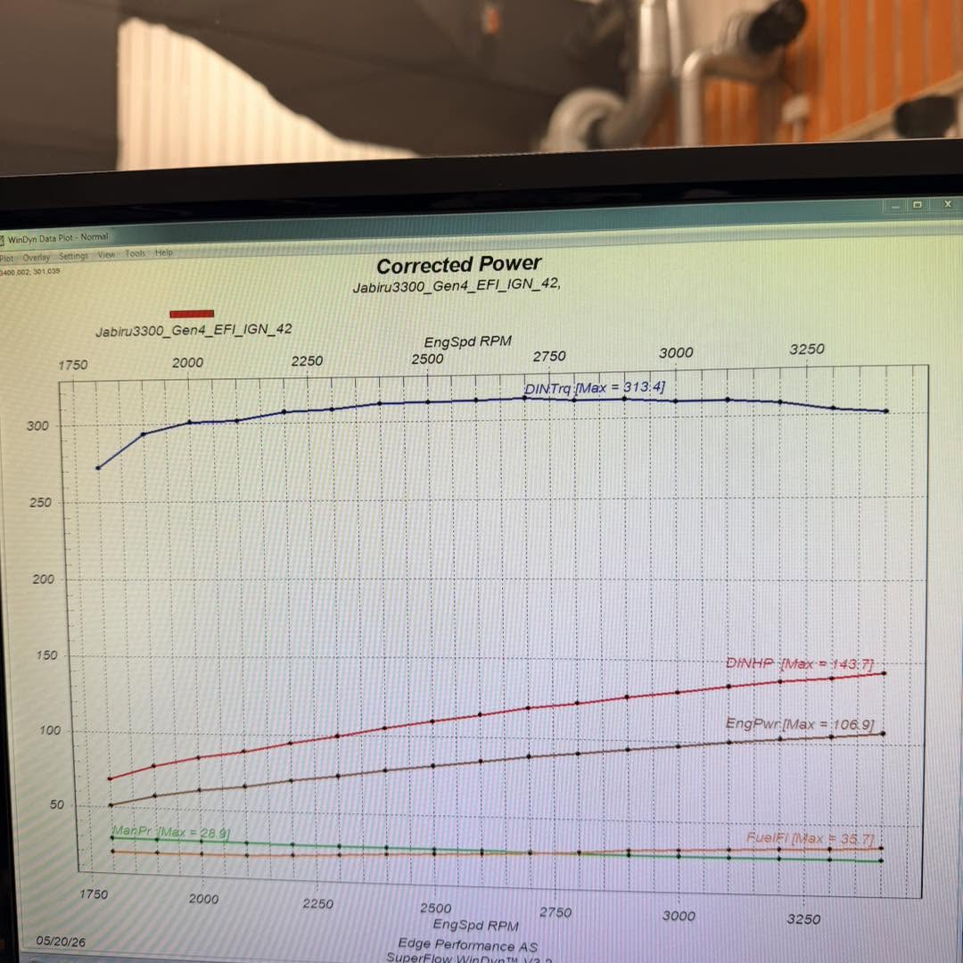

The Edge Performance modified Jab 3300 could be an option as well. With their system upgrades, they are getting ~140+hp out of the 3300. watching that develop as a compare to the UL350is option.

Bryan, the edge jabiru is very interesting and I think will be a huge upgrade for that engine to get fuel injection. I don’t want to be on the leading edge of engine development though. The UL has now been around for quite some time in the current configuration. The edge jabiru is a little too young in development for me but I’m watching closely.
