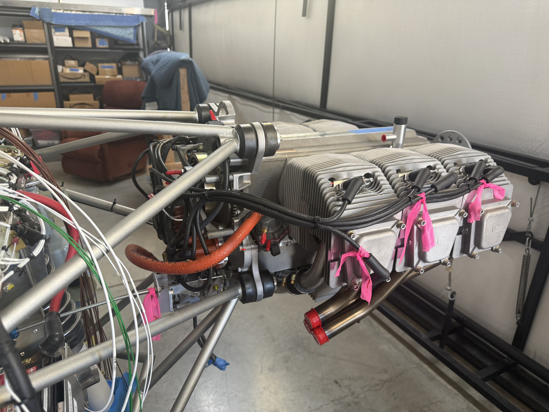

My engine choice was made entirely be chance. A gentleman reached out to me about a Jabiru 3300 GEN 4 for sale at a local airport and connections were made to view it. It was mounted on a Zenith and the builder of that aircraft had changed his mind about power plants and was wanting to unload the new never fired Jabiru. It came with the muffler, air ducts, and other accessories and he was wanting to make a quick sale for $15,000, a $12,000 discount off current pricing and no shipping fees!
Crazy deals are out there, I am extremely happy this one came my way.

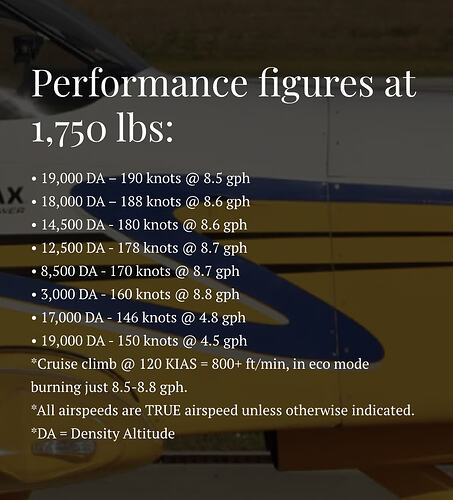

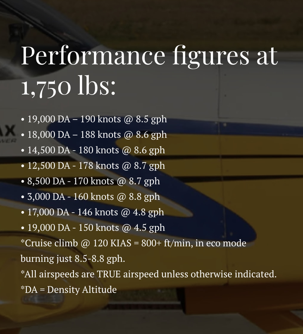

They’re obviously different aircraft, but the RV-9 with a 916 has some pretty crazy performance numbers, especially at high altitude:
