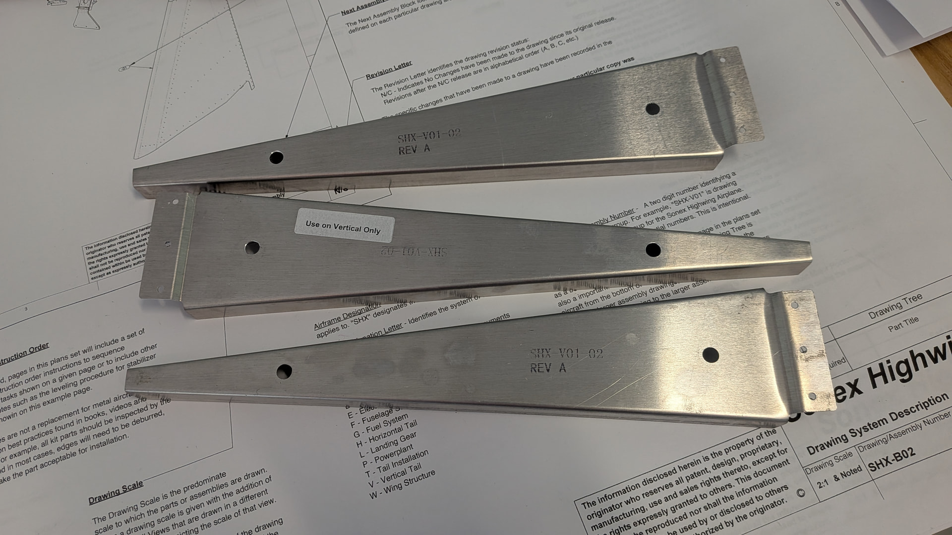

I’ve also done a very quick review of the plans & one odd item is SHX-V01-02. The kit includes 3 (1 for the vertical & 2 for the horizontal assemblies), but one of them is labeled “Use on Vertical Only”. As far as I can tell, the only difference is that it has slightly different pilot hole spacing & doesn’t have the rev A label.
It isn’t terribly important, but I’d be interested in knowing why they didn’t use a different part number or call out the rev a designation in the BoM.

I have the three marked the same way. These hold the fiberglass tips for horz and vert stabs. Chris Atwood had a post that the early kits had the three root holes did not match the rib holes in the structures. It appears to have been fixed in later kits. Not sure why they do not have separate callouts.
Love the old sckool white sticker!
Yep, I get one to clean off!
On the early tail kits these were all the same parts thus the labeling. However, the end ribs in the horizontal have different spacing. Somehow the wrong spacing wound up being saved in the horizontal on Solidworks and not caught pre-production. The easier route for people with assembled tails and the simpler way to fix the issue for future builders was to change the tip rib hole spacing to match that of the end rib. Going all the way back and fixing it at the root of the issue means the spar flange holes on the tip would need to be changed and the end ribs plus new tip ribs. Much easier to match new tip ribs to the existing holes. = 1 new part per side instead of 3 new parts. Especially for those that already assembled the horizontal before discovering this. I was the first customer to complete a HW tail assembly and this was the only part problem I ran into. Mark sent new ones out in 2 days. Pretty good for a brand new design. There was 1 other mismeasurement on the rudder skin which is updated as well so make sure you are using the latest revision for each plan page you start on. The only other issues I ran into were just typo/spelling errors. Nothing that could trip you up. I suppose the part callout is not changed because then every set of HW tail plans already printed would need to be updated in many places. 1 little sticker makes it clear where to use each. Enjoy!
