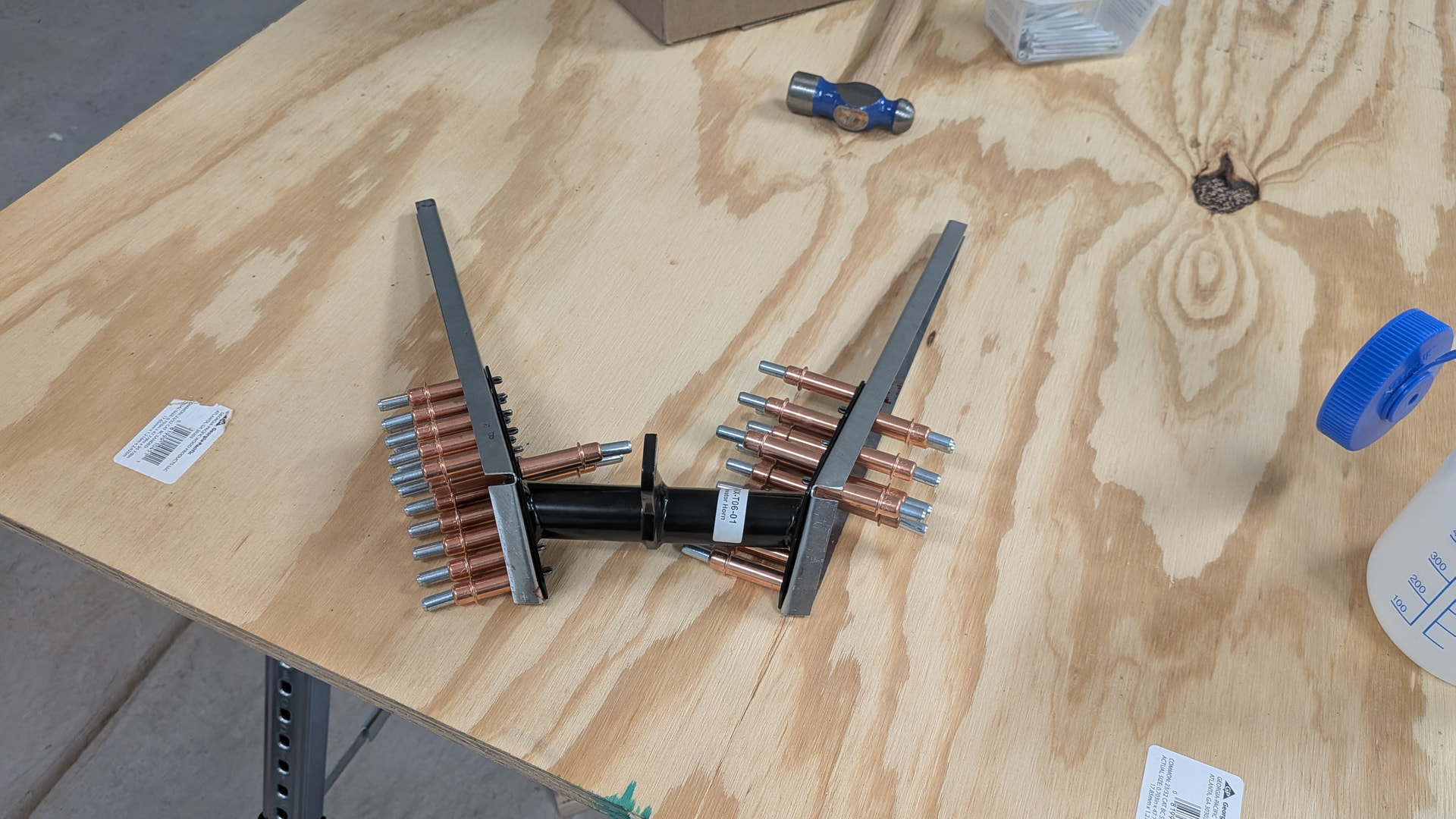

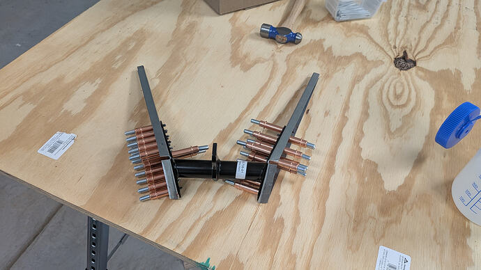

Travel’s kept me from doing as much as I’d like, but I’m making some incremental progress with the elevator root assembly - it is drilled out to #30 as of this morning.
I’ve used the granite countertops in my kitchen to check that the ribs are aligned, and it is pretty much as close as I think is possible - they’re maybe a 32nd off.

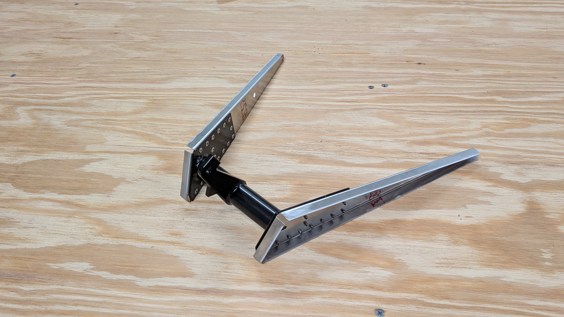

Elevator root assembly complete!

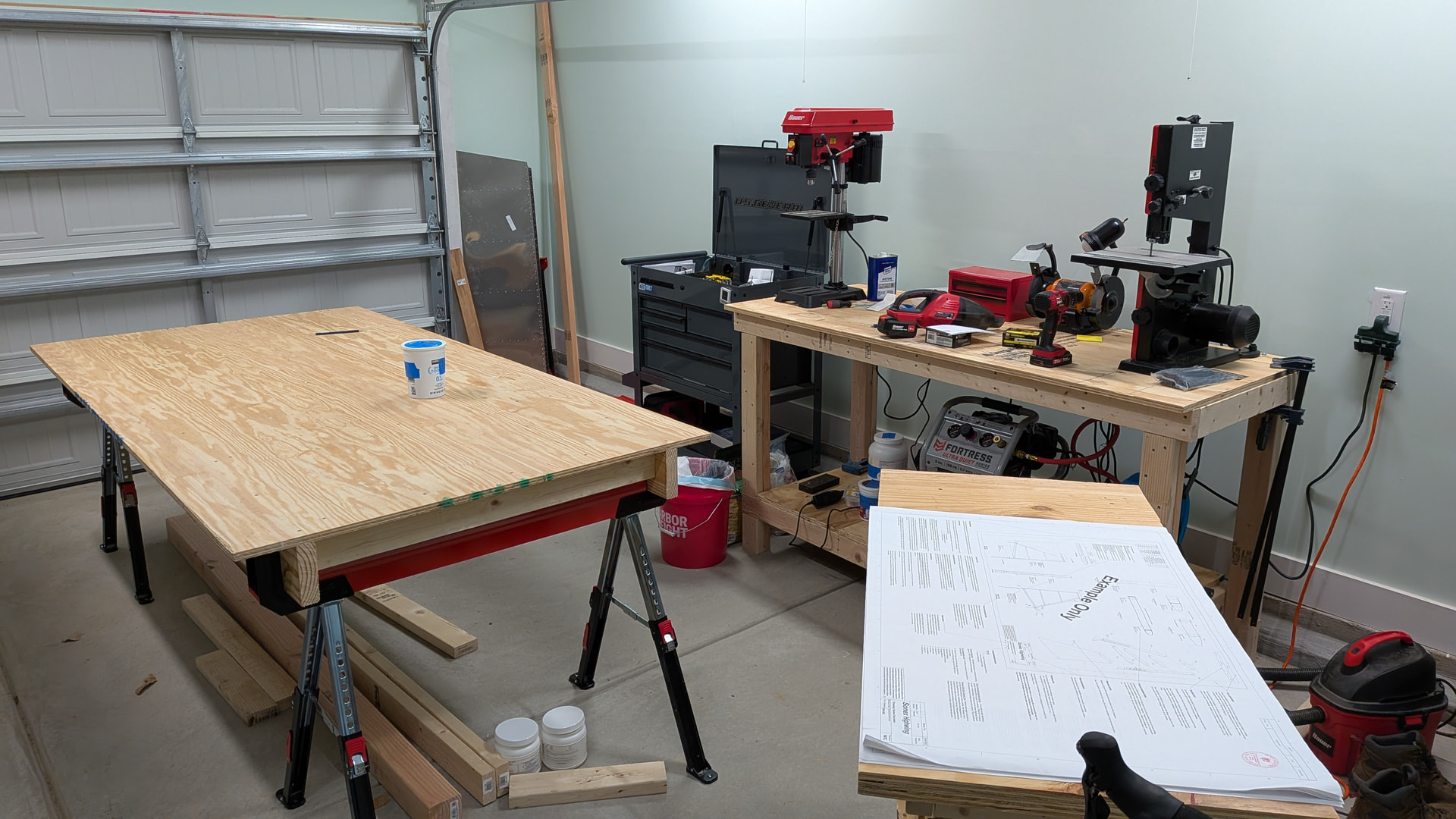

Also, this is where I’ll be building. There are some shelves behind the camera & I’ll likely end up putting more in the corner where the zenith rudder I built is standing.
The compressor I’m using is from Harbor Freight & we’ll see how it holds up, but it is INCREDIBLY quiet. It’s advertised as 66db and I can easily hold a conversation with someone while it is running.

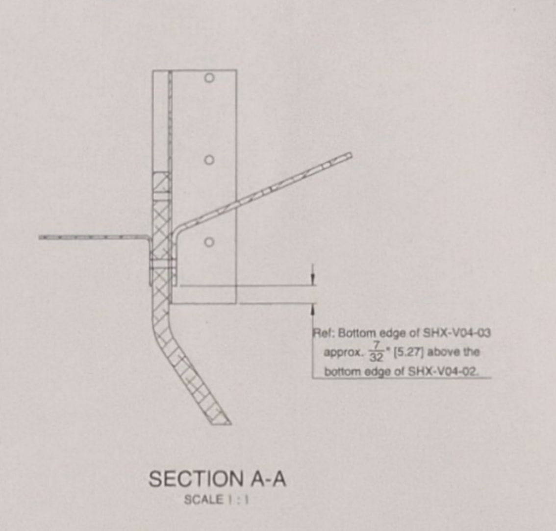

Completed the vertical stabilizer forward spar, and everything fit together well. I did make a small mistake & put the bottom row of rivets in backwards (they’re the opposite of the others), but they drilled out easily.
The plans call out an approximate measurement from the edge of a clip to the edge of the spar:
  • Given that the parts didn’t require any fabrication, any idea what the purpose of this callout is?
  • It says “approx 7/32” - what sort of tolerances should I have in mid for things like this?
Awesome job! The first of many rivets you will likely have to drill out.
I’m not a fan of approximate measurements.
My guess is that, since even laser cut parts are marginally different, you can allow that skin to slide one way or the other slightly to allow your overall assembly to be square. Just a guess though. The previous owner of my kit completed both stabs before I bought it and I haven’t really looked at the drawings for them (and they may be different from your Phoenix parts anyway).
No clue on that measurement. Just check it and move on. Probably will make sense some day later in the build, or maybe not.
Thanks, I’m certainly going to try to keep an eye out to see if it ever matters.
