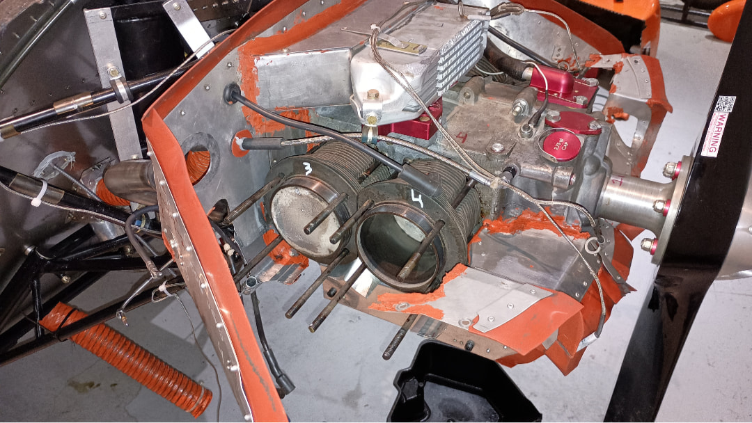

I pulled the rockers off, and placed them on the heads I just rebuilt. Side to side shimming was good, I needed another shim under the blocks.
I get to see the pistons a lot.
On the bright side, I’m getting good at this.

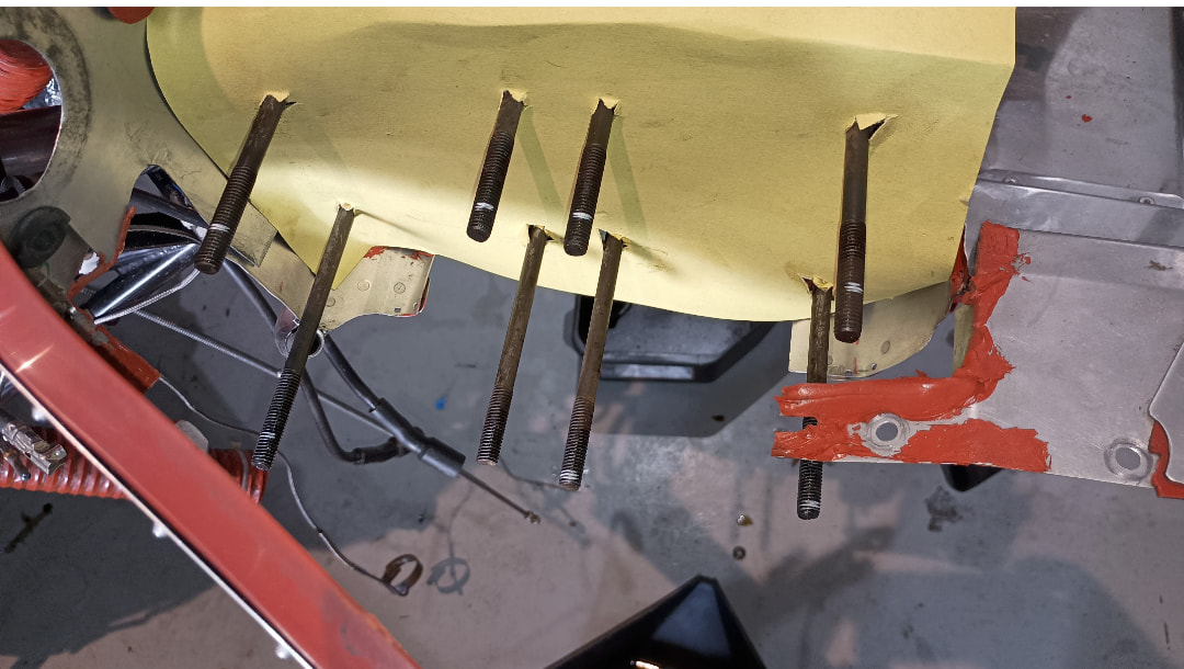

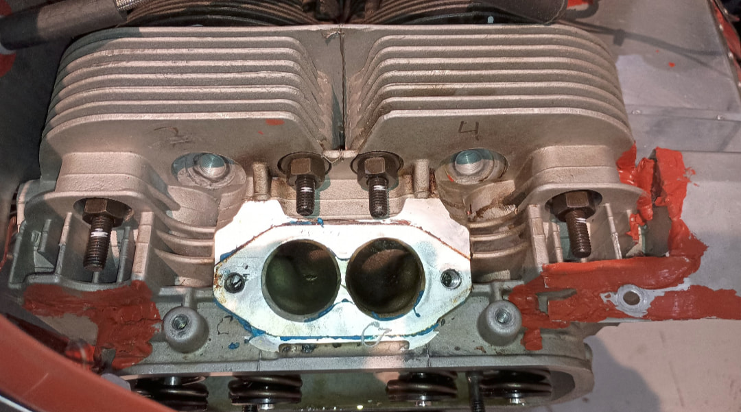

Some of my cylinder studs are longer than they need to be. It always bothered me a little. Dead weight, and low clearance on the manifolds. I had to trim some during the build for the rockers, and then trim them again when I changed to 1.25:1 rockers, but I did the bare minimum.
So before I put the rebuilt heads on, I decided it was time. I made this little shield for the trimming operation.

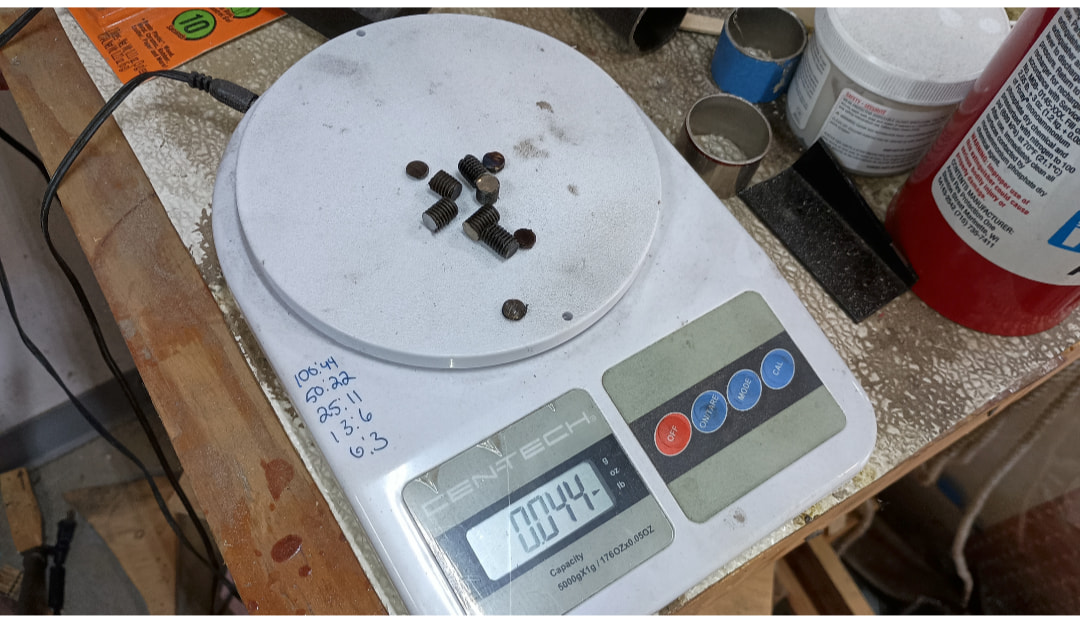

I collected all the little pieces I could find, weighed them, and I saved almost an ounce. Makes it all worth it!
That display is reading pounds.

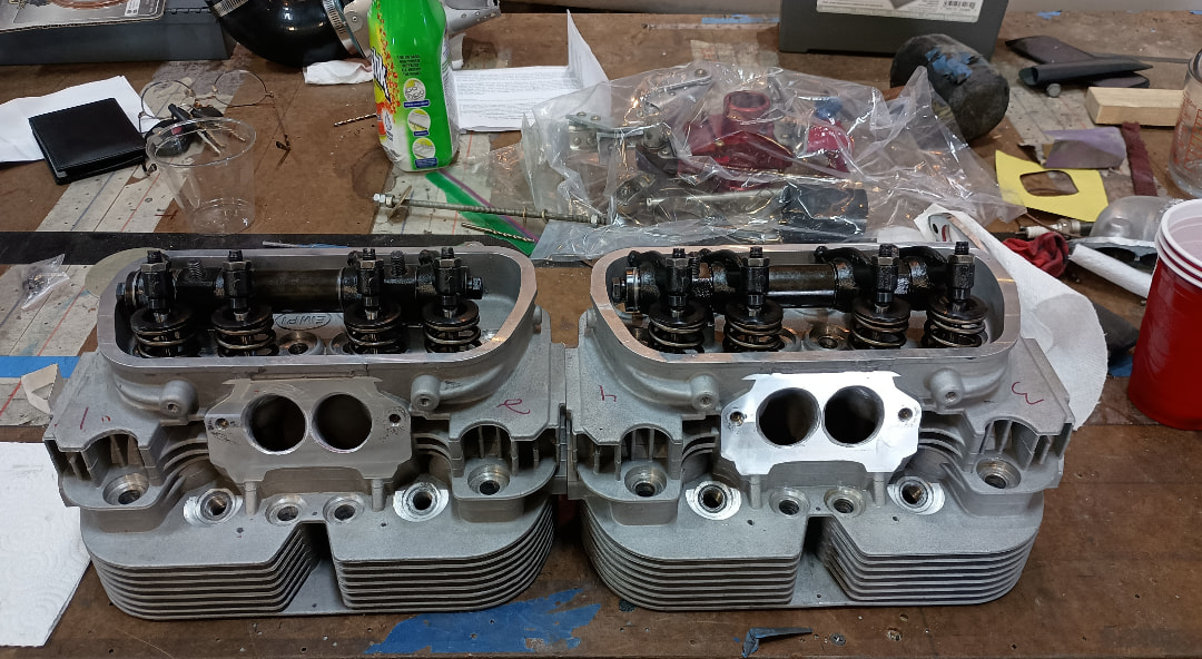

Heads are back on, valves adjusted.
