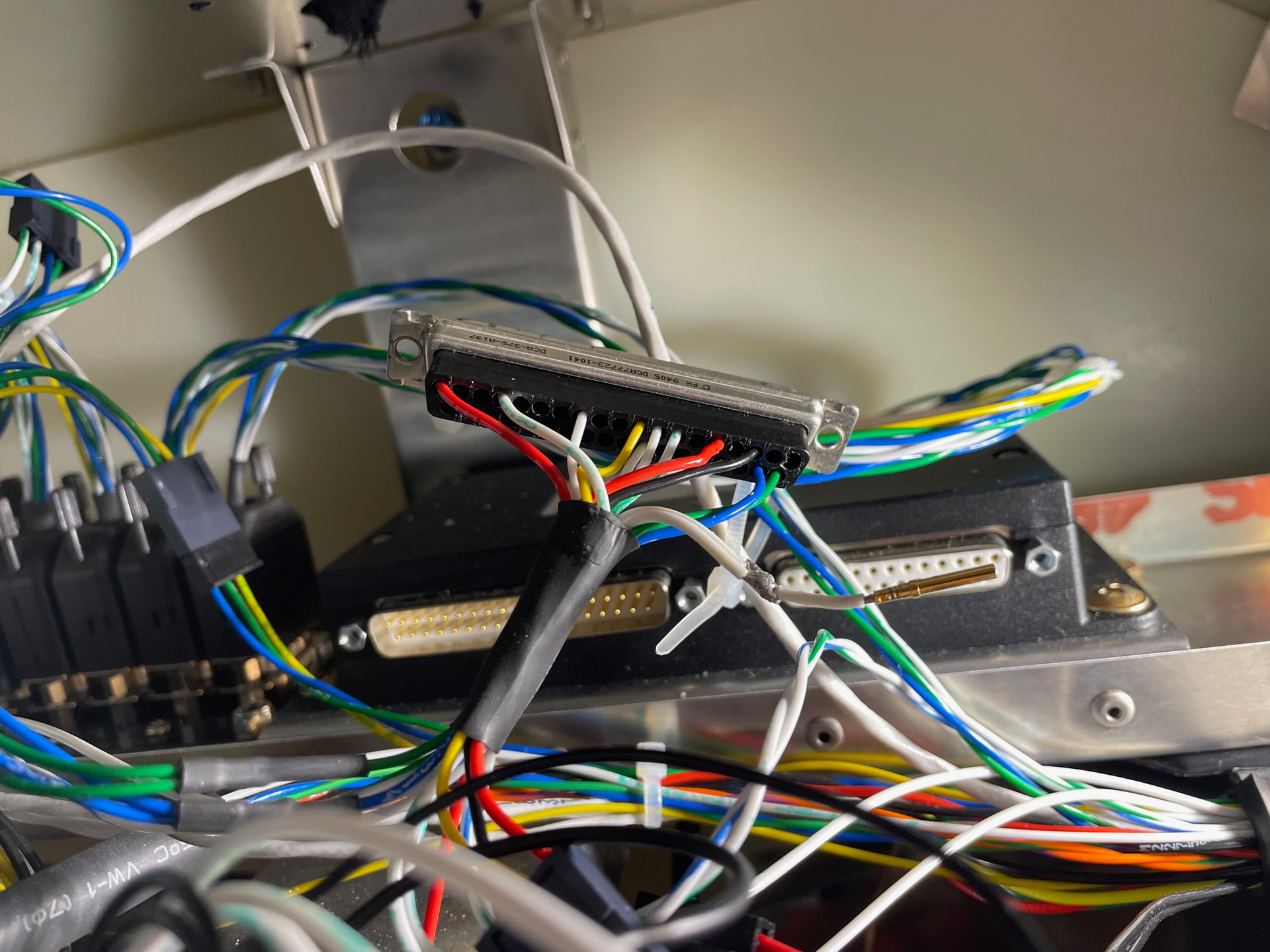

I know this is an old thread, hoping @pappas is still around to answer, I intend on putting a full Dynon in my Model B. Can you tell me where you installed all the components?
I can’t remember if Lou joined us, but you can find contact info here:
On my A model, the air data, heading sensor, and network boxes are under the seat on the passenger side, along with the roll servo. The engine data box is on the left side of the fuselage forward of the flap and brake handles. My SkyView monitor sits on the pilot side of the hump. In the panel/glare shield.
I wish the engine data box was accessible from outside the airplane., because it’s impossible to reach without pulling the windscreen, tank, and glare shield. Consider putting it forward of the firewall.
Under the seat is good except in a crash. Something to consider.
On my A model:
Transponder: under seat
Com radio: Behind seat by ELT
GPS: on top of glareshield
Network hub and EMS: behind panel and fuel tank on a piece of channel I added (see image below)
ADAHRS: I’m still testing positions, was originally going to go to the right of EMS but have wires with too much current in the area
For the EMS the Dynon manual says not to mount on the engine side of firewall. I have an access panel on the right side of my panel behind where my iPad goes so it’s not the most convenient but I am able to work in there. I used a right angle D-sub connector PN: NOR1822-ND to get clearance to the fuel tank but had to move it back further since the fuel tank bowed out a little once I put some fuel in it.
If you scroll through here there’s some other pictures of my install: Legacy Sonex 1417
Dynon has an avionics installation tray that mounts behind the panel that the screen mounts into. It has mounting holes for EMS, ADAHRS/MAG sensor, and COM radio (maybe more), enabling access to these items can be had merely by removing the screen. I like this idea but if I’m going to have to relocate one of those devices because of how the Sonex is built, then it’s not all that great an option. Access to EMS is important. The Dynon EMS module is not made to live forward of the firewall and will litely require an enclosure, blah, blah, blah….
