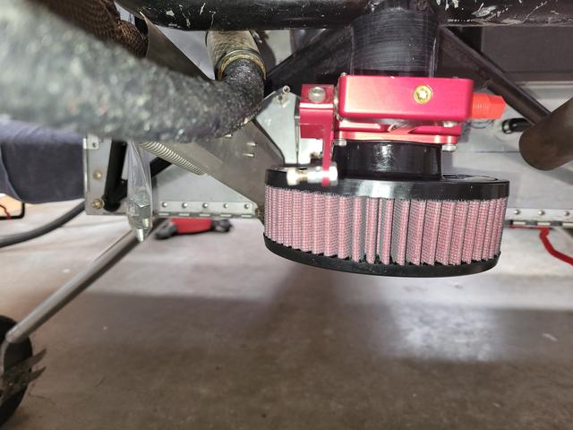

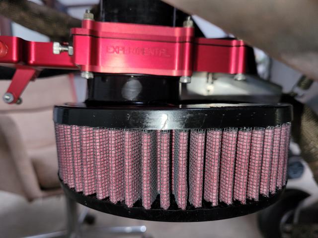

Hi Guys,
I’m in the process of switching from a Zenith Carb to an AeroInjector. That requires me to totally redo my induction system (Outside Air). The clearance between the cowl bottom and the air filter seems to always be a problem. In my search for the “perfect” filter for the AeroInjector, I ran across the K&N RU-045V. The filter does not hang as low as the standard Sonex air filter assembly, it provides more filter area, and it requires no extra plumbing. The input flange is a tight fit but after forcing the bell of the AeroInjector into the opening the filter sucks up on the beveled portion of the input bell and sits there tightly. The input flange of the filter is offset which means it sits no further forward than the Sonex filter. It does have a vent in the top that I will have to seal.
I obviously haven’t flown it yet, but this will solve some fitment issues I’m having. If tuning goes well with this filter, I’ll be a happy camper.
Next, how-to fab a housing for the filter.

That looks like a good solution. I’d definitely switch filters for my VeeCU installation. I’m thinking I’d want ram air if the AeroInjector mixture was in cutoff, else it should be open in back.
I will have NACA on the front of the cowl. I still don’t fully understand why ram rise would cause a problem if I have a forward-facing fuel vent line.
I would also like to have ram air but I’m planning to leave my aerocarb in the original configuration since aero conversions doesn’t advise it.
I’ve often considered that. I think well-designed ram air could give you a higher static pressure than a pitot-tube type thing.
I don’t necessarily want ram rise. However, I had it with the Zenith and I have to either use or patch the hole in the front of my cowl. The problem with ram rise is that there is a possibility of adding back pressure to the fuel inlet which would lean out the mixture. However, if I have the same ram rise being forced into the fuel tank, it seems they would cancel.
If I have problems, maybe I’ll vent to that vent hole in the top of the filter. That should fix it.

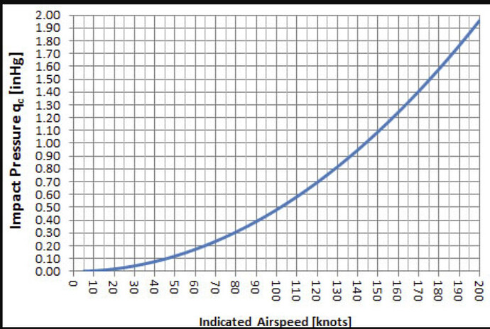

Ram rise only helps at full throttle. That is climb or race mode. In climb, at 100 MPH (86 Knots), you only get about 0.35 IN.HG. rise. That’s about 1 HP. In race mode you could see more like 3 H.P. The big win is feeding the engine cooler air.
Now I do like this filter! It would ‘fix’ the same problem I had with cowl..filter interfacing, while, maybe, increasing the overal area of the filter. I will look into getting one! Thanks!
