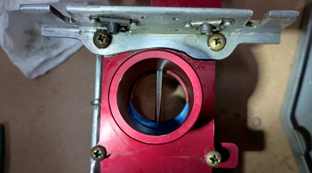

When I was done, here is the Aeroinjector 1/8" from WOT. This is basically how far I have to pull the throttle back to get to the original needle profile. You can only see the 1/8" back mark because the WOT mark is in the fuel orifice.
not quite WOT

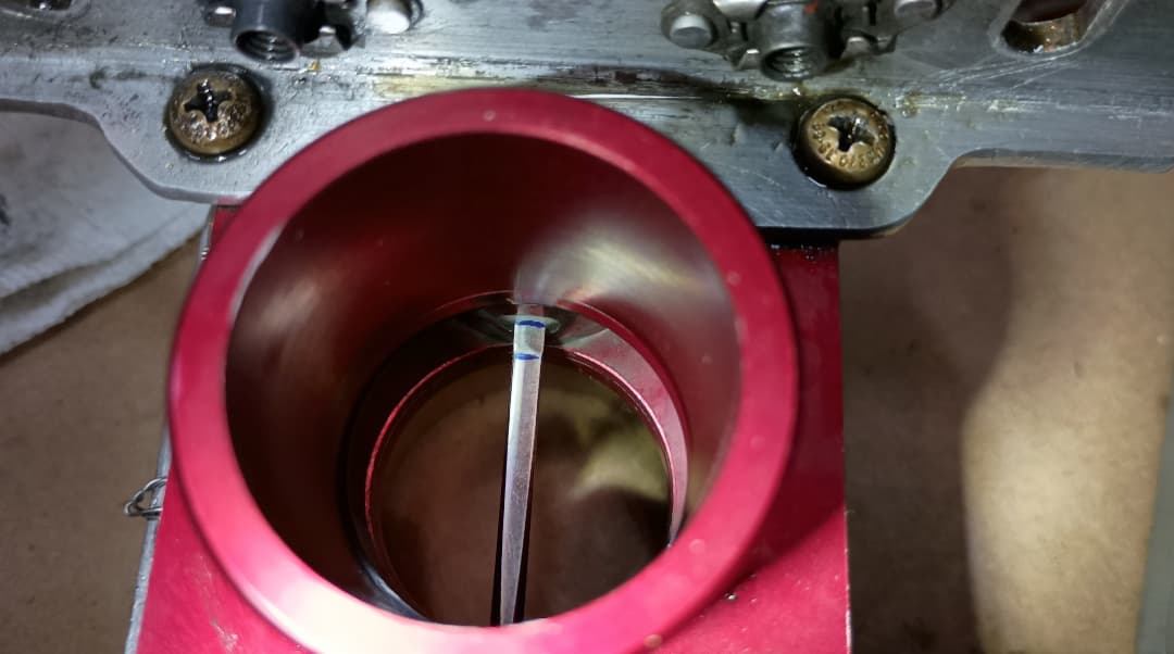

WOT - note you can see both blue marks. There is more fuel orifice area due to the 0.008" skinnier needle at that point.
needle shown WOT
