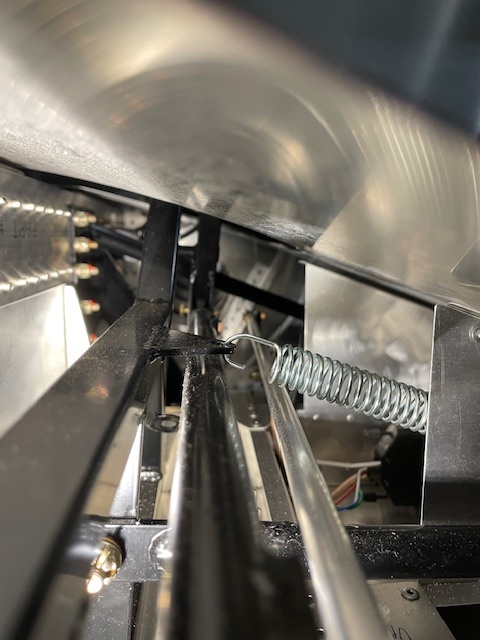

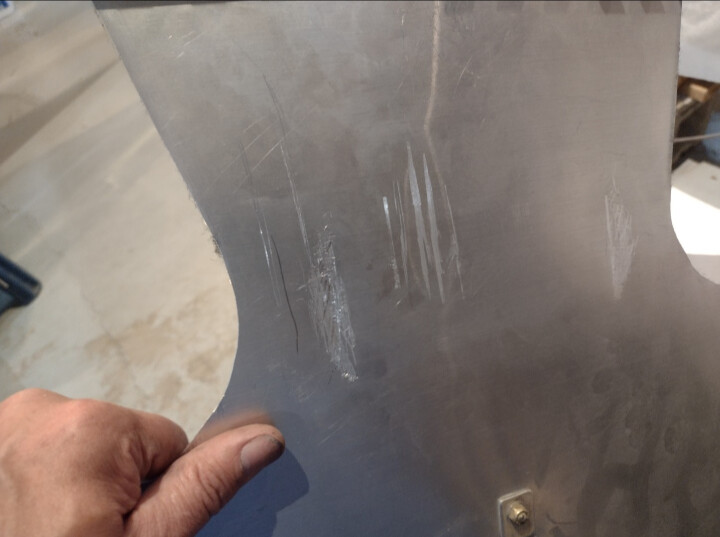

After a year and 130 hours, I have some interference issues that have manifested themselves. I first noticed that the sticks were a lot freer when I was solo and wearing a chute. My chute is a seatpack and basically all my weight is supported by the back of the seat. So under the seat pan, I found this evidence that the stick mount was scraping the seat pan:

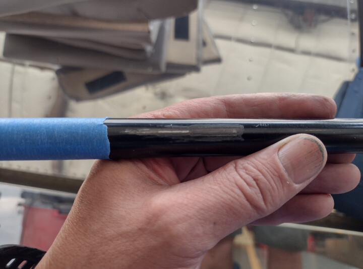

As I was working my fix, I also noticed a scrape on the elevator pushrod between the stick mount and the idler:

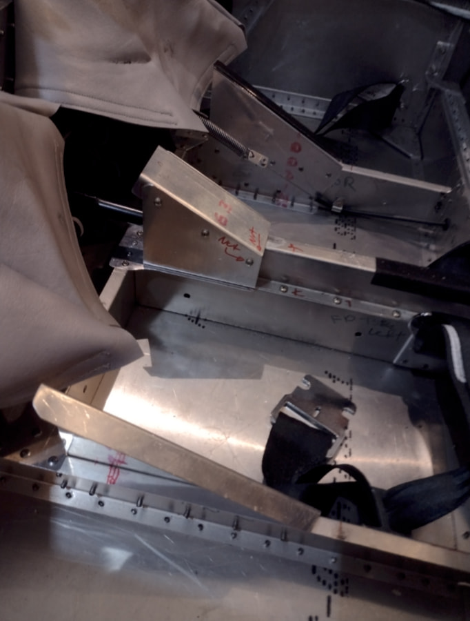

I fabricated a hat section with the angle that I expect the seat pan to follow:
I rested it in place, put the seat pan on, and evaluated. It seems good and I am going to rivet it in.
So I was super meticulous about ensuring no interference before, but with all the seat cycles and maybe Gs it changed over time. I may make a couple of similar hat sections to go on the sides.

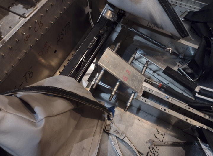

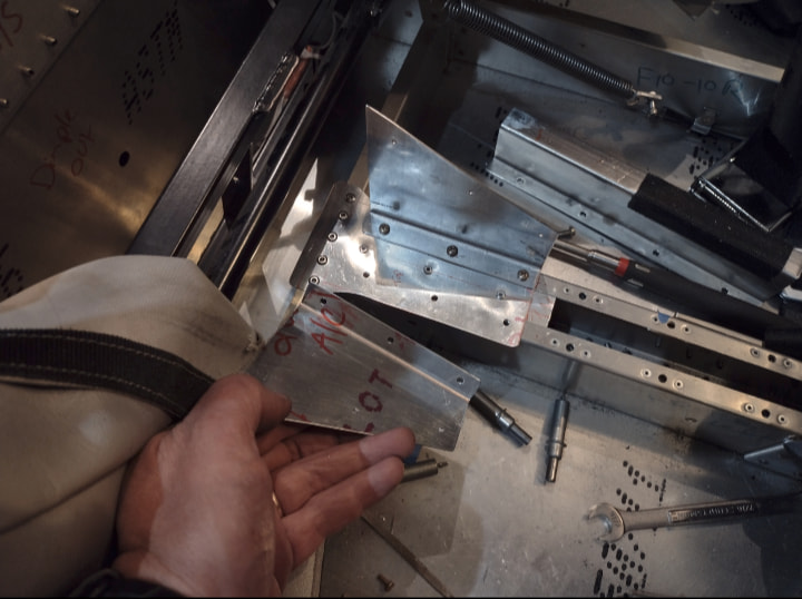

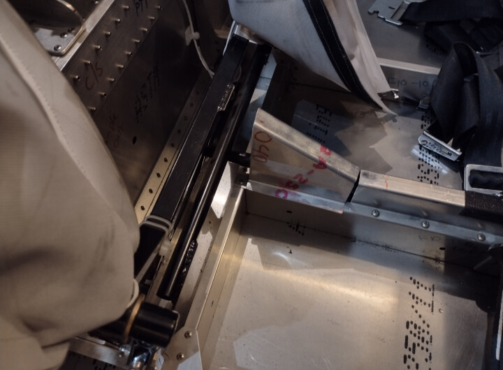

My original tapered hat section was no good. Not enough clearance on the pitch pushrod. So, I made a 3 piece version. Here is one side installed, and one in my hand:
I screw the other side down, and then put the top in. Those clecoes will become nutplates and #6 screws.

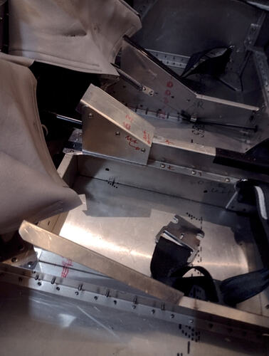

I did a trial fit of the seat pan and it seems good. I am going to extend the other two channels as well, so it is supported more than just in the center.

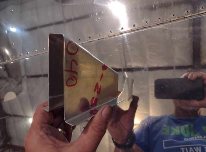

Here is my finalized seat structure. This adds 0.6 lbs at 75".
It seems like I have plenty of clearance now.
All the parts are made from 0.040” 2024-T3 alclad, because I had a bunch in stock. The right rib has a duct tape shim on top, to make everything coplanar.

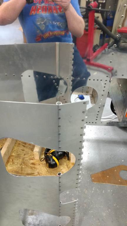

I don’t have much experience being 6’, but you may want all the room you can get. Here is a picture of Adam with his 6’ 3” buddy he took for a ride a couple of years ago. It was tight! Adding those supports like I did made a world of difference.
