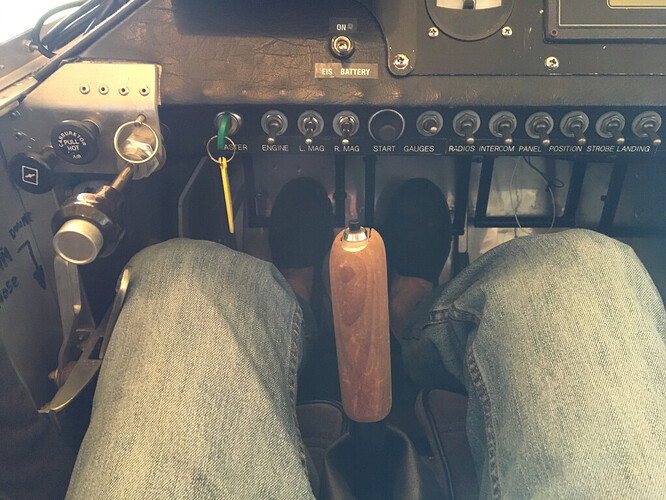

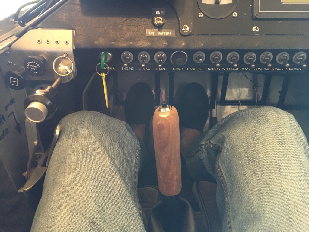

I recently completed my Sonex B conversion.
I have been doing some engine running and testing over the last couple weeks.
I am very disappointed in how much leg room there is in the B model.
The seat attach points have been changed. I suppose now it resembles the seat position for the lowered seat modification.
I’m tall, 6’ plus a fraction and I have to leave the back cushion out in order to have room for my knees under the panel.
Previously with the dual stick I could spread my knees and have plenty of room. BUT with the new Center stick I am not able to comfortably move the stick for left aileron. I never had this problem in the Legacy model.
The back of the seat previously attached to the rear spar carry through. Now it is forward of the rear spar carry through shortening the distance from the rudder peddles to the bottom back corner of the seat back. It shortened the distance by over an inch.
It’s wider. Harder to build and has less leg room.
Anyone want to buy a B model?

Posted: Tue Nov 21, 2017 9:05 pm
by Lbrandt
Paul
I hope to be able to fly in a week or so if we get a semi warm day in Wisconsin plus I need a fresh biannual, mine ran out Oct 31 or I would have flown it already.
I’m looking forward to seeing what the numbers are with the UL260IS. It seems strong on a few high speed runs with lots of forward stick. It’s going to be much better than my AeroVee. I’ve got 25 Hours in phase 1 and probably 3-4 hours trying to get off the ground. Once I was in the air it was a blast but getting there on turf was hard.
I’m just disappointed because the seat back is farther forward than on the Legacy version.
I’m planning on installing the seat back bottom hinge on the rear spar carry through like the Legacy was done. It’ll help my situation.
I’m also considering an offset control stick. I used a straight stick rather than the y. I knew early on that the y would not work for me.

Xenos B for tall pilot?
Posted: Wed Nov 22, 2017 8:52 pm
by Lbrandt
I did explain my space problem to Mark a couple weeks ago. He really couldn’t see how I could have a problem with the dimensions of the cockpit.
The center stick configuration along with the seat back hinge placement is what created the problem,
I built the very first B conversion.
My Legacy Sonex suffered some damage in a landing after my AeroVee broke a valve adjuster. Downwind landing back at the airport that I had just left about 8 minutes prior plus I was high and fast when I reached the end of the runway. So she suffered some damage so I decided like Kerry said to get the latest and greatest.
I actually had more fun plans building a big share of my earlier Sonex, no waiting for parts, no incorrect parts, no wrong bolt sizes. I thought the plans left a lot to be desired.
I never would have made a post like this when Jeremy was still around but I probably wouldn’t have had to either.
I’ll be happy to post some performance numbers when I get my biannual out of the way and we get some warmer days.
I may just fly it with a local ag pilot rather than wait. I never could have gotten in the air with two people with the AeroVee but the 107HP UL feels really strong. I have the Prince P-Top prop.
Leroy
Posted: Sun Nov 26, 2017 11:51 pm
by Lbrandt
Michael & anyone else that might be interested
I can make it work for me if I leave the rear cushion out of the airplane.
The seat was not changed because of the flap actuator position which one builder mentioned. It’s location is quite far back.
The new control stick is beautifully machined but it changes the location of the elevator pushrod to the center of the airplane rather than offset to the left like on the Legacy so both of the vertical control rod supports in the tail cone have to be repositioned. The most rearward vertical is a real tough one to get to. I had to remove the tail cone bottom skin to get to it.
I have taken photos of how I fit in my taildragger Legacy model and my B-Model and sent them to Kerry.
I’ll try and post those three photos here as well. Of course the one with the stick between my legs is #173 which I still have and the other two are the B-Model, one withe seat back in and one with it out.
I got my biannual done today so hopefully I can fly it this week.
Leroy
Posted: Mon Nov 27, 2017 11:47 am
by Lbrandt
Hi All
I did not try on the B-Model. It’s wider so why would I end up with less room.
Kerry, you’re assuming that everyone wants a center stick. I did not but had no choice in the matter.
The first photo of the B-Model shows my knee almost hitting the sub panel that’s with the seat back cushion in. The next photo is with it removed. I do have a little more room but my right leg is uncomfortably straight and not spread out like it’d like it because the darn stick is in the way.
Of course Sonex can do no wrong.
I have 35k more dollars in this airplane and I’m not comfortable like I was in the Legacy.
DO NOT MAKE ME OUT TO BE THE PROBLEM HERE!
Leroy
More photos are coming
