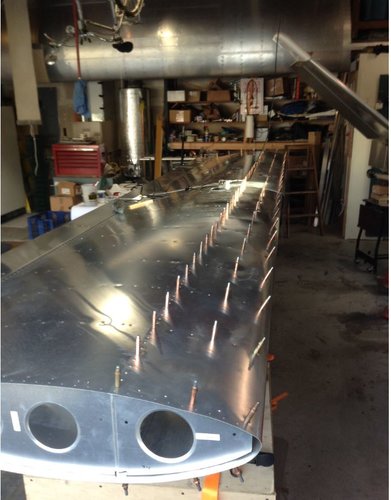

I acquired partially built Xenos 0052 in the Summer of 2018 from sunny Southern Cal and trailered it home to within 30 miles of British Columbia, Canada, to the not so sunny state of WA. After unloading my prize, we had a couple of short vacations to visit friends and relatives and then spent the Fall in Sunny Southern Cal. Go figure. All that to say that I started building the empennage in January of 2019 (was that ever a cold experience), and I just finished my second wing.
Had a couple of interruptions, but have managed to maintain some activity in the shop all the same. If I can keep at it this Winter, I may be in the air in 2020? Engine is in the crate and I have all the basic instruments in hand, so I am hopeful.

Good going Tom. The Xenos is not a trivial build. For a start you’re building twice as much wing as us Sonex flyers. Got to admit I was never the slightest bit interested in the Xenos until I watched one of Michael Jackson’s videos https://www.youtube.com/watch?v=xe4EbVZHw-8. He had been beep beep beep, boop boop booping for about 5 minutes before I realized the engine wasn’t running and I thought, hey, that’s pretty cool.

Keep plugging away. Soon the tiny speck of light at the end of the tunnel will get bigger and bigger. I built XNS0068 in 2.3 years…retired.

Thought the wing building would never end! Speaking of Michael Jackson’s 0042, it now resides in Washington State in Seattle. Another Michael now owns it and should be flying next year. He is VW buff and has torn the engine all apart to make sure it is ticking just the way he wants it before he flies. My engine just returned from Arizona and is ready whenever I am. Got plenty to do in the meantime.
