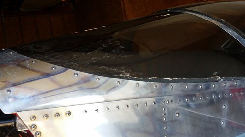

Accidentally spilled a few ounces of fuel (mogas). The windshield was severely damaged breaking out of frame. See pictures.
Has anyone replaced a windshield with Plexiglas acrylic? Seems like fill location with Lexan is problematic.

sorry to see this happen to you. when i refuel i have a towel i put over the lexan to protect it. keep it in the baggage bay. a few others have spilled fuel, with the disasterous results. i think its good to keep lexan as its good for bird strikes. the bigger canopy is plexi, easy to blow and easy to polish. lexan very easy to scratch. id get a new piece from sonex. home depot carries lexan, but clear no tint.

My Onex windshield was damaged in the first few hours. Then I read the manual. The Onex fuel cap is through a hole in the windshield and just a drop of fuel causes a crack. When I had a leaky fuel nozzle it ran down the firewall bow and caused 50 little short cracks in the front edge. My cracks are vertical. parallel with the centerline of the windshield. One next to the fuel hole is about 4 inches long. I’m replacing the windshield, at 300 hours, as we speak with the same Sonex part and vow to be more careful fueling. I bought a fuel pump for 5 gal. cans that pumps 5 gal. in 3 minutes and I don’t spill a drop anymore. Onex windshield is $150.00.
After the original crack I bought some peel and stick black vinyl and put a tapered protected area around the fuel hole that helped with the drips. I’m not sure a towel would be enough protection.

When fuel is spilt on the lexan the only way to minimise the damage is to wipe it off immediately! Before it begins to evaporate. I have used the shirt I was wearing at the time, more than once.

and wes for your experimenting. the lower part of windscreens would get the most fuel due to gravity, and thats where the screws are and curvature starts, , so its stressed in that area.

Note: I tested a strip of the Lexan I cut off of my windscreen during construction. I put held/clamped it into a bend similar to my windshield, dribbled some mogas on it and within a minute it was completely crazed and cracked.
