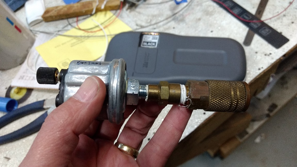

Th best way to be sure the sender is good or bad is to check it by applying pressure and use an ohm meter from ground to the terminal post. Now this is from memory so my figures may be a little off. But with a good sender, the resistance will rise about 10 ohms per 5 PSI. It is a very linear rise in resistance. Air pressure and a regulator work fine.
Steve
Re: Wildly Fluctuating Oil Pressure
Posted: Fri Sep 09, 2022 8:14 am
by XenosN42
sonex892. wrote:Th best way to be sure the sender is good or bad is to check it by applying pressure and use an ohm meter from ground to the terminal post. Now this is from memory so my figures may be a little off. But with a good sender, the resistance will rise about 10 ohms per 5 PSI. It is a very linear rise in resistance. Air pressure and a regulator work fine.
Steve
I agree - use an air compressor. Then you’ll be able to cross check the reading on your MGL device against the compressor’s gauge.

Or an adapter like this:
