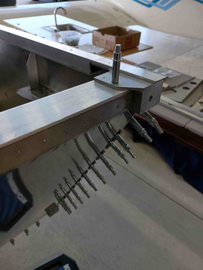

OK, there is no way the upper firewall will attach here. Where did I screw up?

On sheet F17, it shows that the upper firewall is notched to go around the motor mount, etc.
Hope that helps
