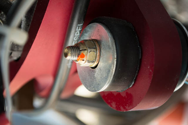

Since you’re entering the engine mounting phase, I’ll add a tip that has been pretty well proven at this point. Include a large washer on the outside of the engine mount bushings, regardless of how the alignment is (add additional washers as necessary for proper alignment.) The bushings WILL start to compress/extrude over time, and the more support they have behind them the better.
http://www.rynoth.com/wordpress/waiex/2 … ng-issues/
It’s a lot easier to add backing washers to the bushings the first time since adding them later either means using a slotted washer or removing the engine entirely to add washers.

Haha! Dangit, when I saw your post I had just walked in the house after bolting up the engine. I used your method and it worked great. Good tip though, I went back out after dinner and re-did it; it only took like a half hour to set the engine back down and mount it again. Thanks!
Good idea too on the slotted washers. If I need to make alignment changes later I’ll just do that; way easier than removing the whole engine again.

After looking closely at your photo I noticed another issue that bothered me with my install (and I talked about in my same blog post about the bushing that I linked above.) In the lower-right bushing in your photo (pilot’s side bottom) I can see that patch of no-contact between the small washer under the nut and the large washer at the bushing.
This bothered me, and I ended up replacing that first large washer with one with a smaller ID.
I understand why they include the larger ID washers in the kit to fit over the engine mount on the firewall side, but don’t understand why they don’t include washers to properly fit under the AN4 bolts/nut/washer that hold all of your thrust.

Yes! I noticed that too. I’ll go pick up some new washers next time I get hardware. At least those ones are on the outside though so I can just replace one at a time without yanking the whole engine again.
How tight are you supposed to tighten the mounting bolts? I just snugged them up for now but I was a little unclear on exactly on how tight they should be.
