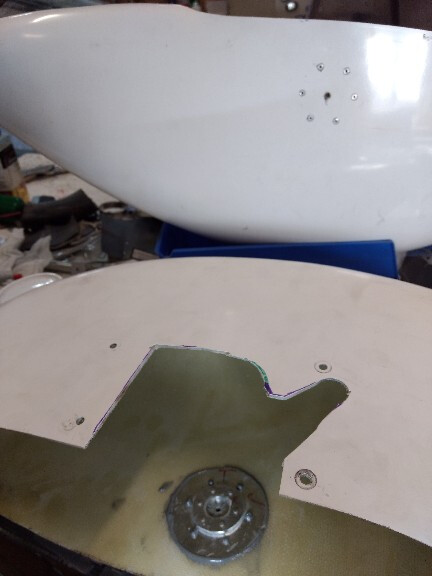

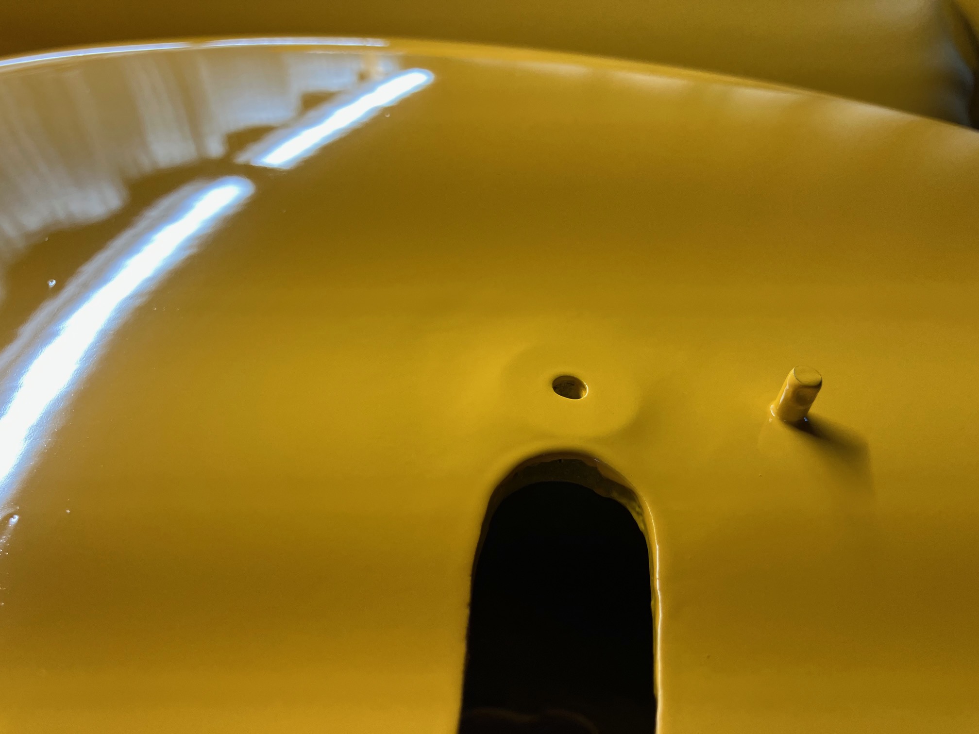

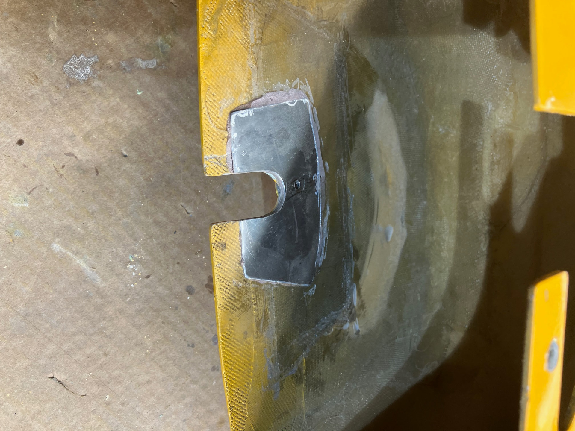

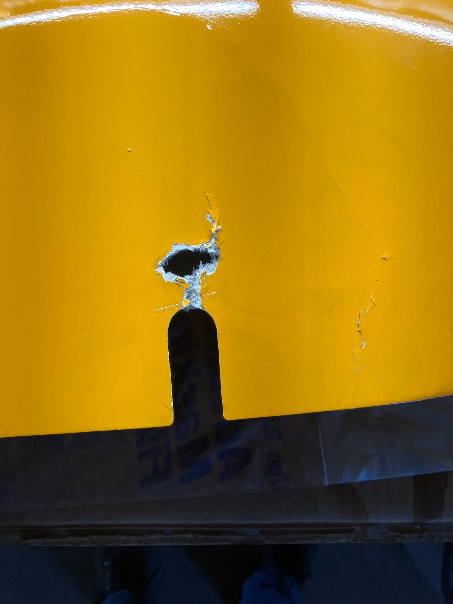

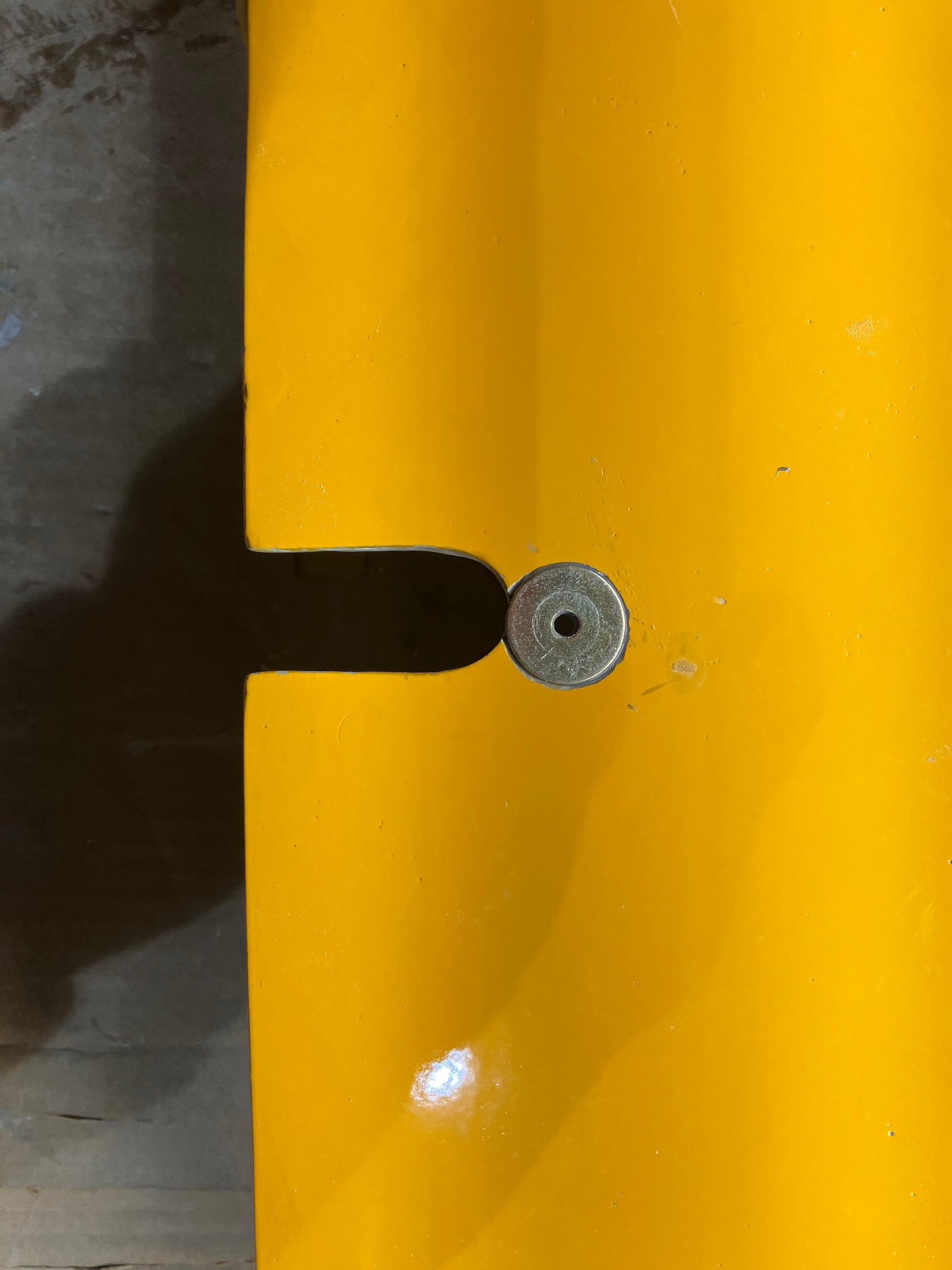

I realize Kerry would never approve of this post because it is a modification to the plans - but, I have an improvement over the plans wheel pants attachment. My original wheel pants attachment was done exactly as the plans called for. I’m not sure why, but my outside screw would loosen during flight. I tried Locktight - but this did not seem to help. This may be an anomoly only with tail draggers - not sure. In addition, I realize that these wheel pants were designed for a 130 mph aircraft - mine is closer to 180 mph. I was doing some practice touch & go’s at our airport when I noticed that something did not feel right with the handling of the aircraft. When I landed, my 3/16" hole was now over an inch in diameter and the fiberglass was severly damaged. I realized that I was just clamping across fiberglass - and this was clearly not sufficient. So, I decided to go with a belt & suspenders approach. I epoxied a .025" aluminum facing to the inside of the wheel pants - the end of the axle will now contact aluminum directly. I also epoxied an AN970-3 washer to the outside of the wheel pant. I counter sunk it a bit - but left it proud to the surface. Lastly, I threw away the “Washer Head Screw” and went to a drilled head AN-3 bolt. I then epoxied in a clevis pin that was drilled and safty wired the bolt to the clevis pin. I know this is probably overkill - but wanted to share my experience with anyone still in the build process. These are easy modifications to make during the build.

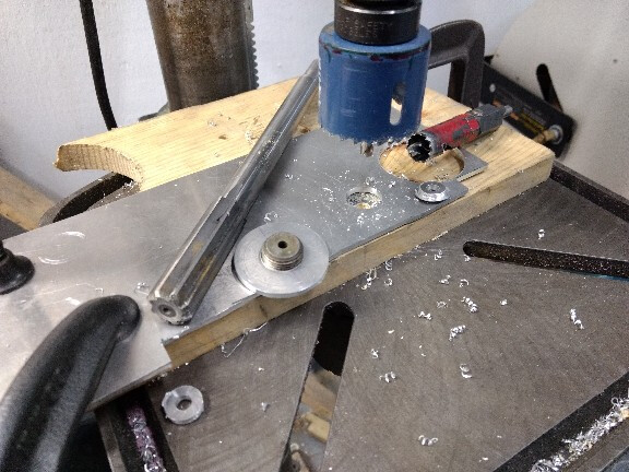

First I made these big “washers.” They are made of .125 aluminum, and have an ID that will just slip over the axle. In this picture you can see a finished one over the stub of the axle we cut off earlier. To make this part, I first holesawed an 11/16" hole in the sheet and then reamed it to .750ish. Then I used a bigger holesaw to cut out the washer.

Though I’ve only exceeded 180MPH once, we kept losing the #10 screws on the outside. So I did this:

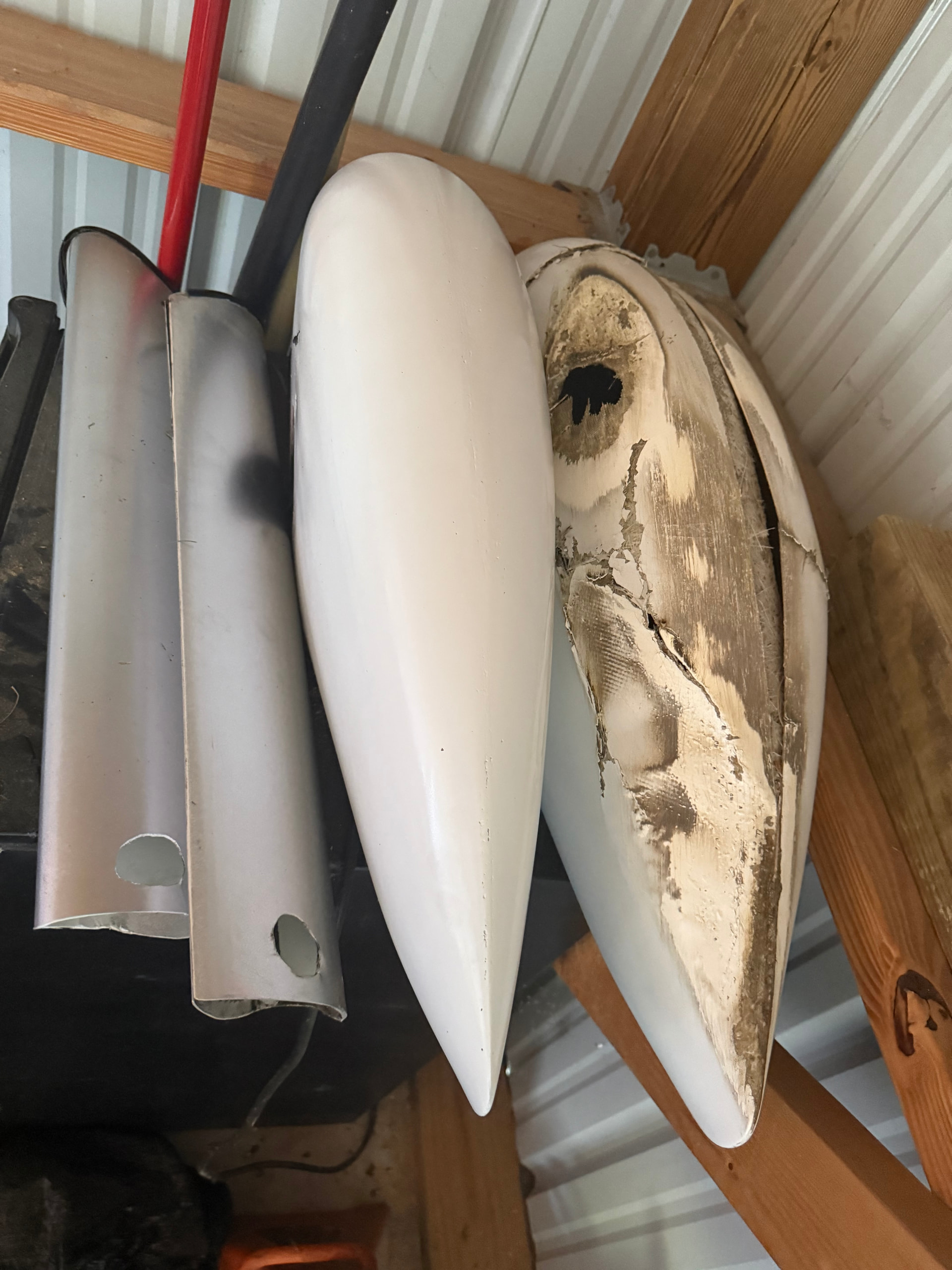

I took my wheel pants off and installed larger tires. I fought with the retention of the pants and they worked well on pavement but when flying Young Eagles off of turf the left pant failed and rotated forward as seen in this still shot from a departure video:

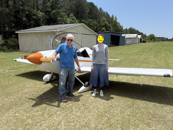

The landing wasn’t too exciting although I eventually needed all of the rudder to keep the plane straight on roll-out after touchdown. Here’s a photo of me and my passenger (the identity of the young lady that was my YE passenger is preserved) after landing. She was not shaken at all:
A photo of the pants and fairings after removing them. Now with the larger 5" tires it behaves much better on the turf and the speed loss is small enough that I don’t really notice it:
I have a set of Van’s wheel pants that I may install at some point but I do like the look without them. Here’s a photo (posted before) showing the larger tires in use and again I’m flying Young Eagles off of a turf runway:

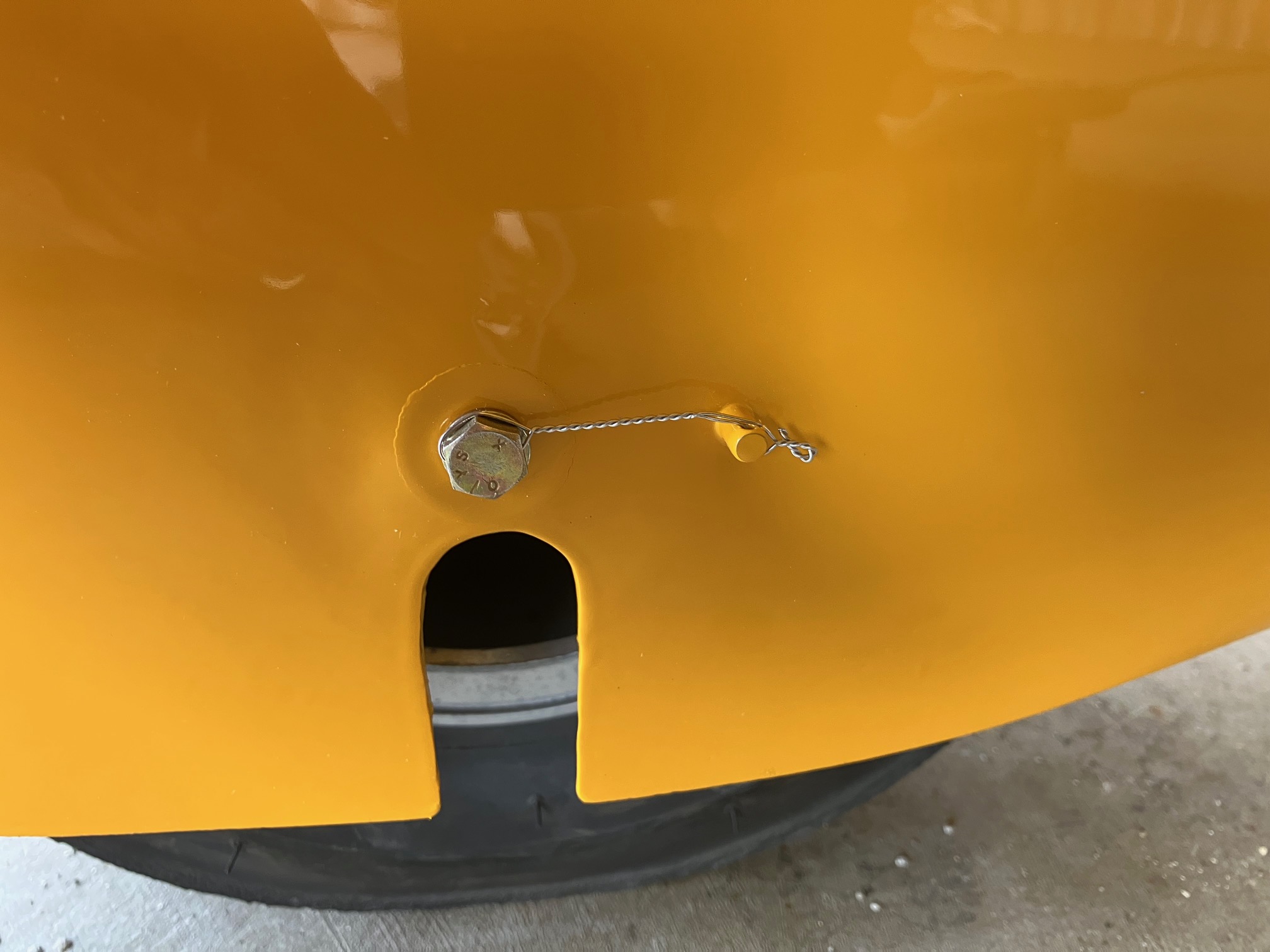

I did something a bit different that worked well. Since I was using the larger tires and the wheels were a bit further out on the axels due to having O’Keeffe hydraulic disk brakes, I slit and spread the bottom of my wheel pants and added in a filler about 3/4" wide. But also needed something to hold the outside wall further from the end of the axel. Made a spacer, stiffener, from about a 5/8" square aluminum bar, about 4" long and machined down to about 3/16" thick for all but the center section that contacted the end of the axel. Riveted that inside the wheel pant with a couple of rivets each end, and knocked to mandrel out of the center two leaving holes through which safety wire was routed. Had a friend who also landed in one of his wheel pants, so used two bolts on the inside wall of the pants, and one of those was also safety wired.
