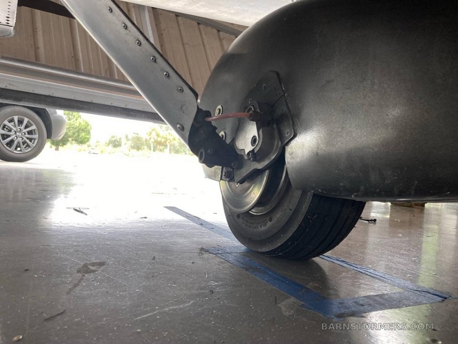

Clearly not a popular topic :slight_smile: I cut the wheels in half today, and it’s a better fit than I expected. I’d just need to spread the two halves apart about 1/2" to 3/4". I should probably have waited until I upgraded the brakes from mechanical to hydraulic to see if that moves the wheel in or out a significant amount, but almost certainly some modification would still be needed. I’m still tempted to order the RV-8 wheel pants kit. Most of the RVs use the same wheel pants, but the brackets are different, and the -8 brackets are made to mount on flat gear legs.

Posted: Fri Mar 25, 2022 10:18 pm
That looks good. A little fiberglas effort and you’re in business.
