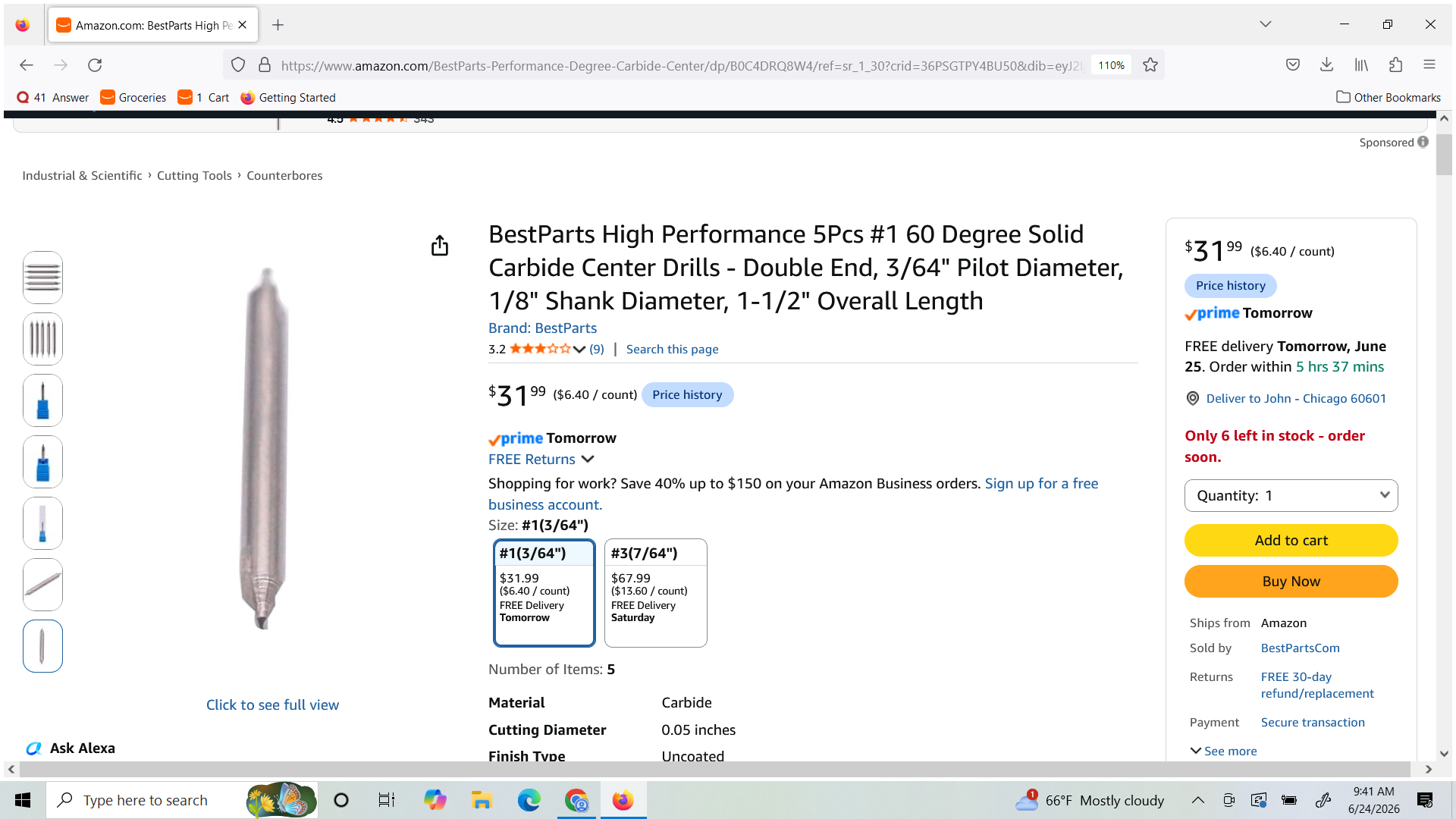

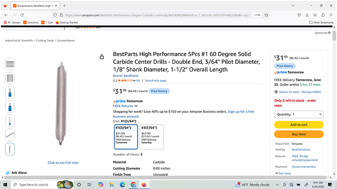

I’ve been banging my head against this wall for a while now. In my frustration I decided to try a 1/8" centering bit. What a difference.
Amazon.com: BestParts High Performance 5Pcs #1 60 Degree Solid Carbide Center Drills - Double End, 3/64" Pilot Diameter, 1/8" Shank Diameter, 1-1/2" Overall Length : Industrial & Scientific
