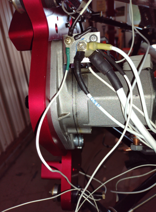

My A model kit came with a fuel shutoff.
I have a ground bus under the panel, which is just an aluminum angle. This is for avionics. It connects to another aluminum angle under a starter bolt which is the ground for everything under the cowl.
You don’t really need a power bus. Power goes to the main breaker and then feeds all the other breakers. I have the output of my master going to the starter and the main breaker.
The sky-tek starter that comes with the Aerovee kit has an integral relay. I just have a pushbutton going to the start terminal.
I really like my mechanical master switch instead of a conventional electric solenoid. Saves some weight and saves 1 amp - 5% of your Aerovee output.
