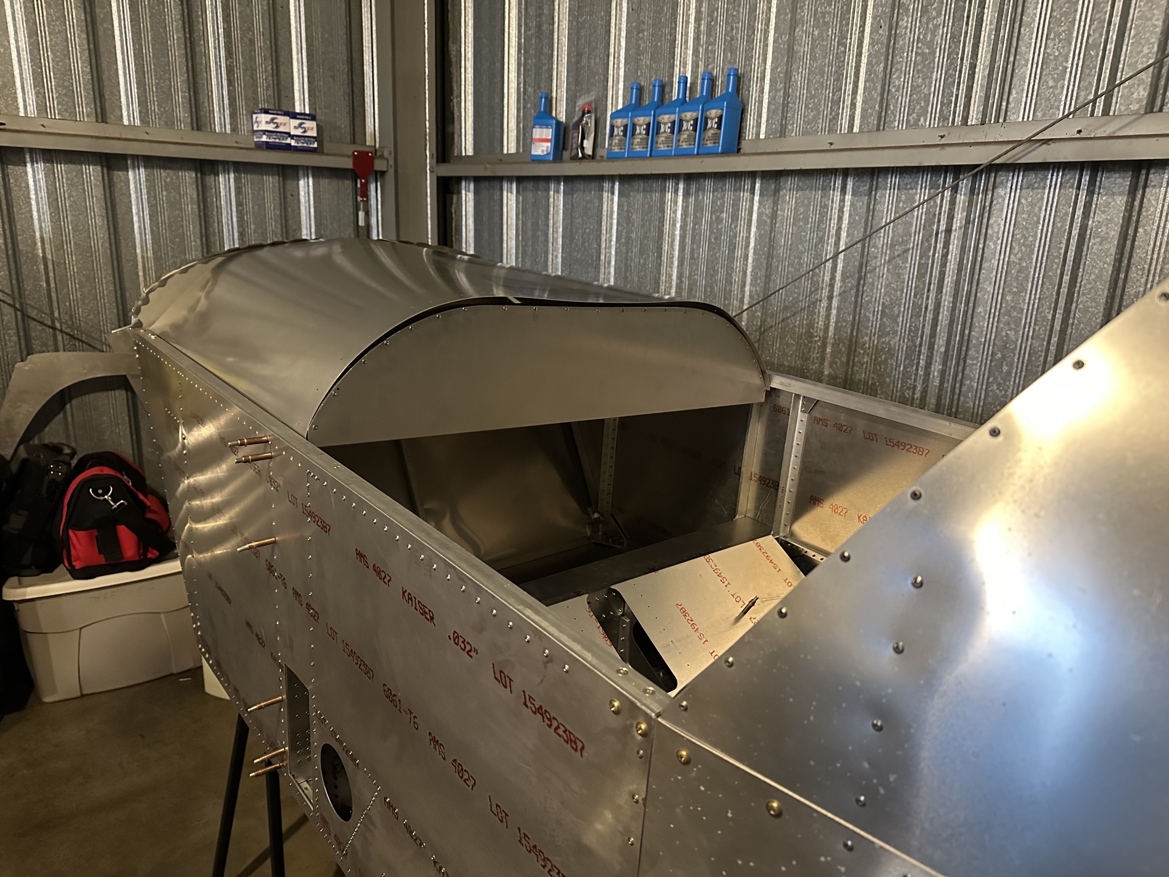

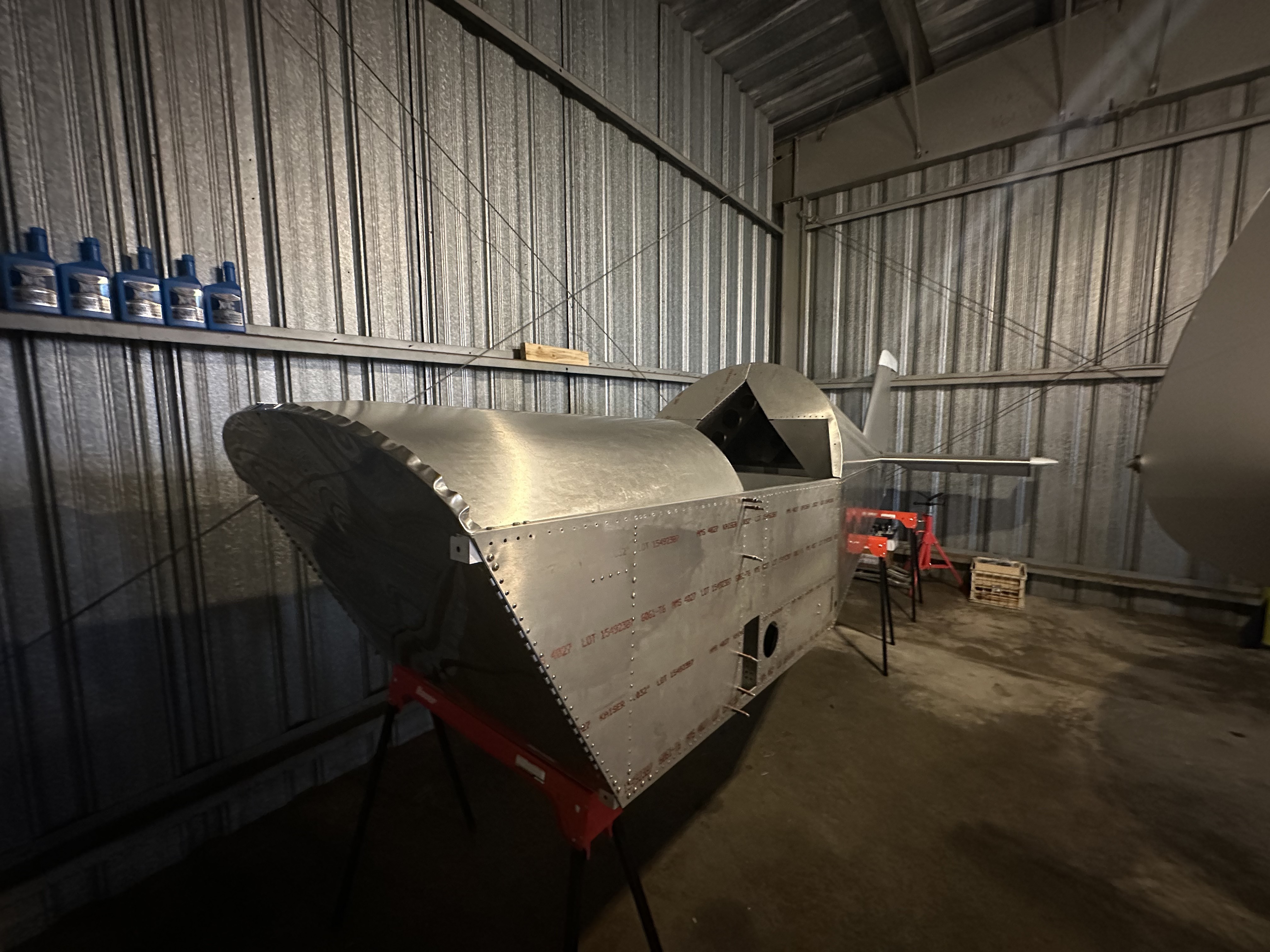

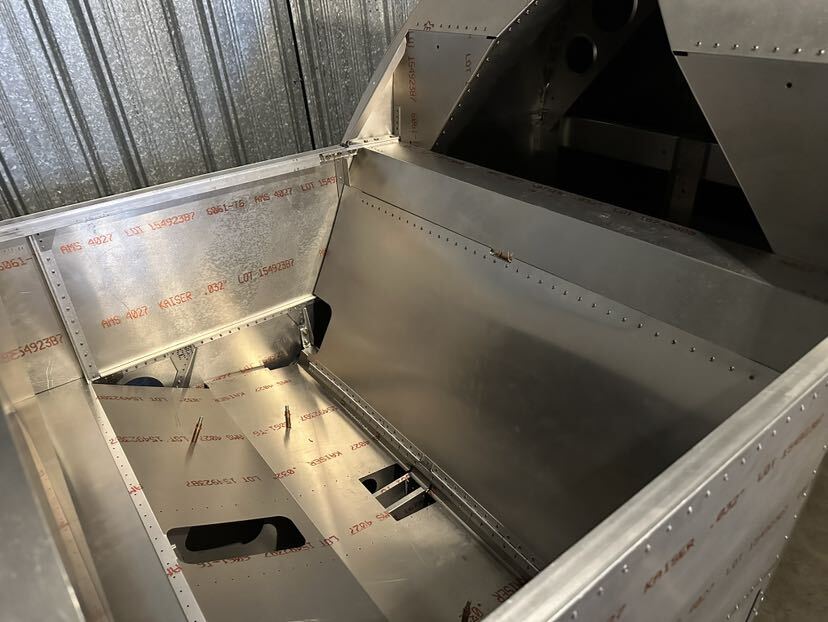

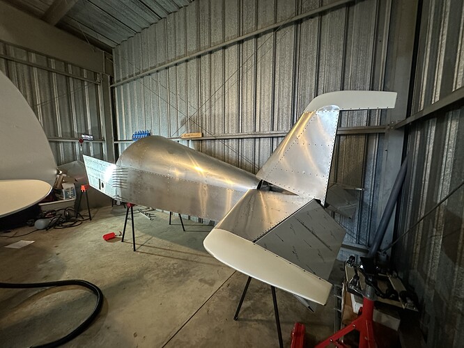

I came a across this ad on barnstormers for an almost complete fuselage and tail subkits for a sonex-B. The owner sent me some pictures.

If you have an opportunity to, ask to see the build logs for what the previous builder has done. My opinion is that you can (somewhat) judge workmanship on how detailed the build logs are (plus, you can ensure documentation exists to prove it was truly amateur built). As far as overall condition, nothing stands out in the pictures you posted to make me question build quality. In general, I would be checking that rivets aren’t missing in holes (the plans can help you determine which ones shouldn’t be installed yet; look for one rivet missing when it’s neighbors are installed), places where it looks like an assembly is forced (wrinkles in skin or odd-shaped overlaps, and edge distances (holes too close to the edge of parts).

So in the pics those parts have a pretty good probability of being good. The fact that it is in a hangar says that hopefully the person who built it is an aviation person and maybe aware of the points above. If it was built by a first-timer with no aviation experience, that’s not a bad thing as long as they followed those 3 things above.
Probably the two most important things are the wing rigging and tail attachment to the fuselage. They are critical - wings or tail falling off is bad. The wings haven’t been done yet, and not sure if the tails have been drilled in or not. Even if that is screwed up, you can replace parts and do it over, but it takes a lot of time and some money. So that is the gamble. I know of at least 2 A model aircraft where the wing attachment was buggered up. One by the guy who was doing the project, one by a guy local to me who bought a flying project with some issues including snowman holes in the wing attach. So that is the gamble. On this project only the tail looks mounted and I think that task is easier than the wings. Also, if I understand correctly, the B models went to the wing rigging procedure that some of us used in the A models - drill the spars to size, then use a bushing to transfer holes to the fuselage. Originally the Sonex procedure was a piloted drill bit and that went poorly for a lot of people.
