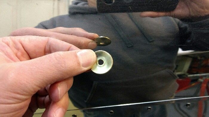

You need to determine what is causing the early stop and solve it. If I recall, I had to bend (concave) a couple of the washers that hold the ruddervator pushrods to the mixer, otherwise they were binding when pitching up and applying full rudder. You definitely want full rudder deflection to the stops at all pitch inputs.

Do you have pictures? If the fender washer hits the rod end, like mine did, you can cup the fender washer. Put a bolt in it, find a socket that matches the OD of the washer, and press the bolt so it pushes the assembly into the washer. Afterwards the washer is cup shaped. Gives clearance on the rod ends, but will retain the rod end if it fails.
