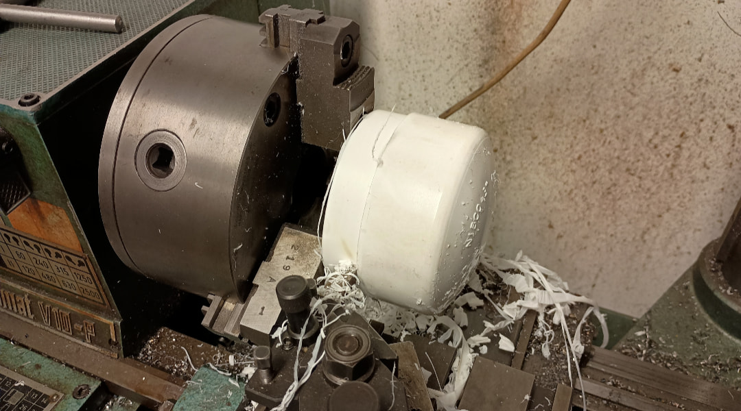

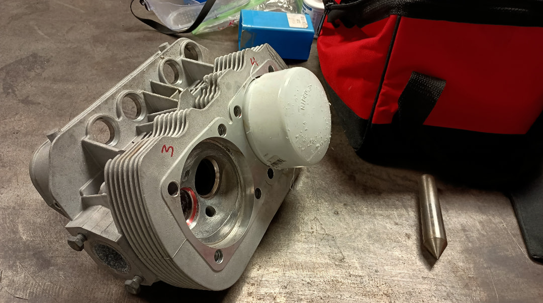

VW cylinder head tester
Forum member ysifl2 sent me this - probably because I complain about my VW heads a lot lately! I’m going to make one.
Also I’m going to try and tag it in the Firewall Forward > Aerovee category.
It didn’t really cross post like we were hoping, oh well. Here is a very similar tool posted some years ago in the old forum:
This is a great idea. I’m going to build one as well. Thanks for posting!
It didn’t post to Categories → Aerovee, but it can be found by looing in: Tags → Aerovee
That’s a great idea. Do you think it will need something to form a seal between the PVC and the head? I guess as long as your tolerance is tight enough, you shouldn’t.
If you look at the picture in the first post, the article says to make a rubber seal from an inner tube.

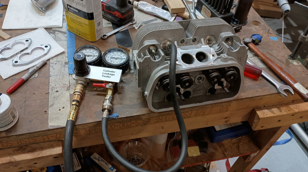

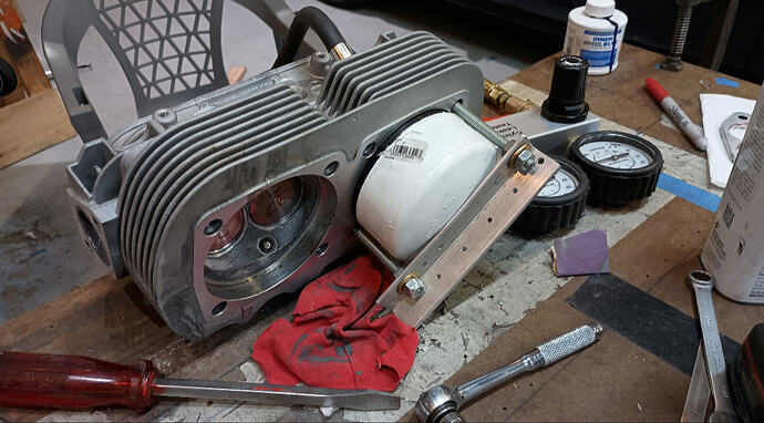

Here it is in action:
One sealing issue is that there are deposits on the head and that can interfere with the seal I think. In that way, Graeme’s tester is better. I did have to mess around with it to get it to seal well.

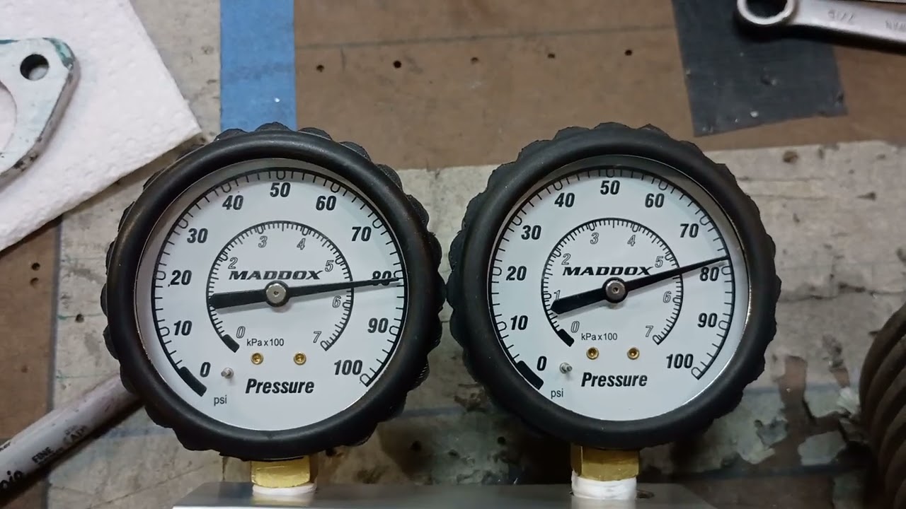

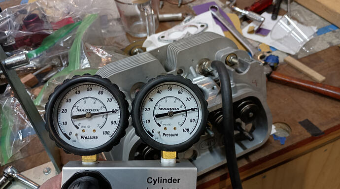

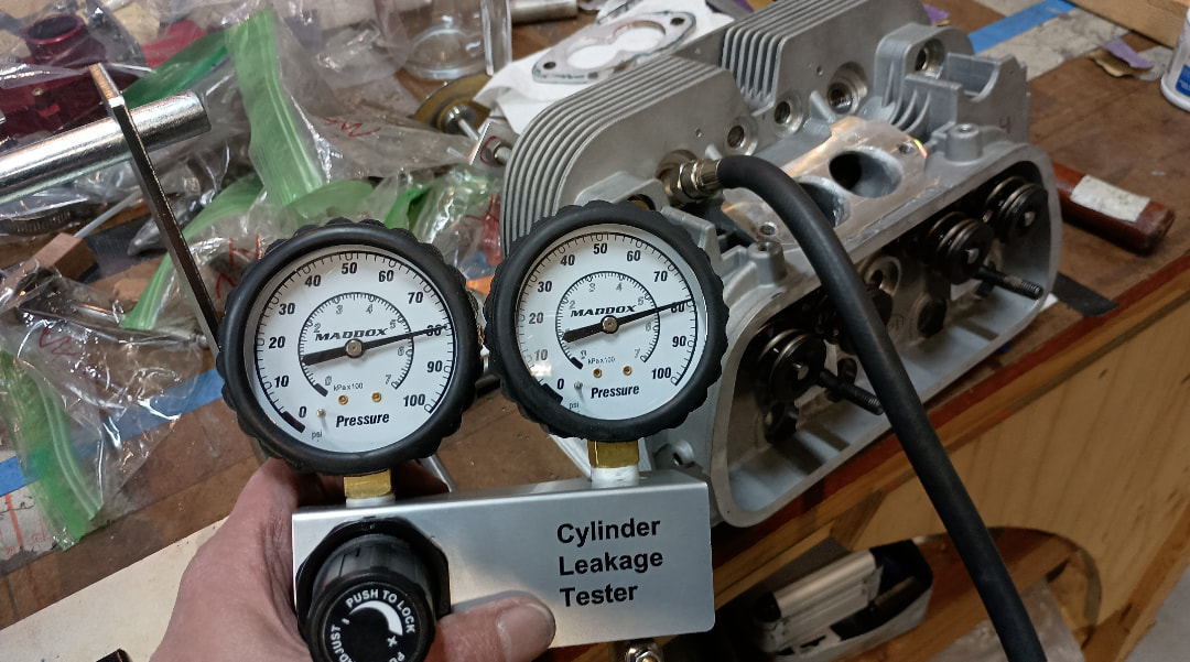

I’m seeing 80/78 on both sides here, with leaks through the exhaust valve. I pulled the exhaust valves out and lapped them more aggressively, no real change. Technically passing, and might be slightly lower given leakage past the rings, but I hate hearing the air shoot out the exhaust valve. Trying to decide - should I:
  1. Go with it as is
  2. Try and lap some more
  3. get out the Neway cutters again and take another pass
Bryan,
Have you tried to (remove pressure and) rotate the valve(s) a few degrees to see if you get any change in leak rate? A bit of run out in either (or both) valve or seat, and maybe you could be chasing a non-repeatable ghost here, right?
“Perfection is the enemy of good…” or something like that
- Voltaire
I staked the valves, meaning whacking them with a plastic hammer while under pressure. They were likely rotated when I tried lapping them again. But I’ve not just rotated them.
Since you’re pretty close already, I’d probably start with lapping and see if it changes for the better.
I probably wouldn’t just go as is. It in spec now, but your leak down test is bound to be worse with a fully assembled engine where you’ll lose some pressure thru the rings.
#4 exhaust. Another pass with the cutters, lapping, 80/80 with a good seal. This was the worst one.
After cutting and lapping, #3 was 80/74 which was a little worse. I lapped it some more, 80/80.
Between the bench leakdown test setup, and the insanely awesome valve compressor, each iteration goes really fast!
Edit: just finished the other head. 80/80 all around. I’m done.
