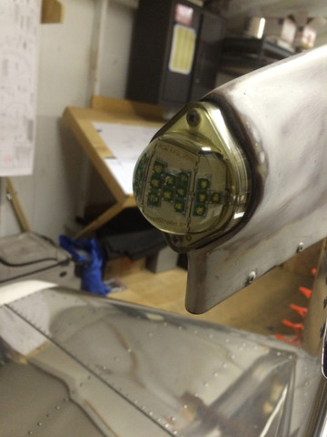

I am mounting an Aveo Posistrobe on this fairing I made. I can post a better photo with the light mounted when I get home

Here is a link to the light I have mounted to the tail. I’ll post a photo of it tonight.

Posted: Sun Jan 25, 2015 8:00 am
by Gripdana
