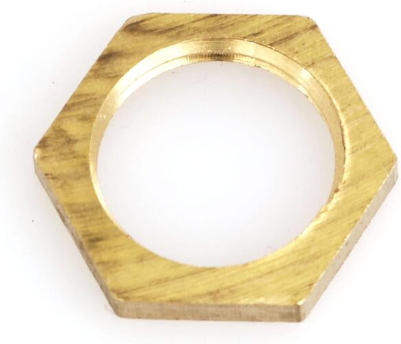

My original VDO has almost 400 hours and is still working - but I would see some pressure indicated after shutdown sometimes. Not sure if it was a sender issue, or a grounding issue. A poor ground would cause resistance and that could be why I was seeing pressure after shutdown. The VDO instructions say use no sealer on the pipe threads, because 1) that’s where the ground comes from and 2) what’s one more leak on a VW anyway? But I have been sealing it because I’ve not come to grips of the futility of keeping the oil in the motor. So I bought some 1/8” NPT nuts:
To make these work I had to run my pipe thread tap all the way through. But I was able to use it after to sock down an electrical lug to the body of the sender which I connected to ground.
I also bought an 1/4” NPT coupler and a 1/4” to 1/8” reducer bushing. My link shows as the 1/4” nut but it was 1/8”.
