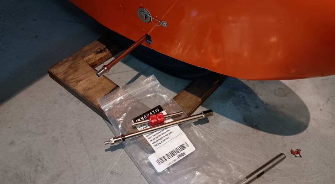

We have holes drilled in the wheel pants to check and fill the tires. For years I used these extensions.
They come in metal and plastic. Many times the top one would unscrew when I was trying to remove the assembly from the valve stem, even if I glued them together. And sometimes I could not get the tire pressure gauge or air chuck to work with them. I just bought a set of 6” dually extensions.
They are awesome. The ones I bought are here:
https://www.amazon.com/gp/aw/d/B07D1H5182
Comes in a pack of 2, spare o-rings, metal caps with a valve core remover, and a dedicated valve core tool.
