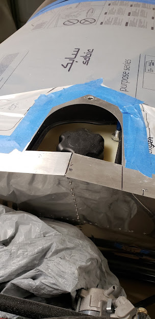

Howdy guys,
I’m working on my cowl. The lower cowl went on and fit well with pretty minimal effort, which was awesome, and now I’m working on the upper cowl. For the most part it also fit pretty great right out of the box, EXCEPT where it slides under the windshield skirt.
I think the problem is the front edge/flange of the skirt is a little bigger than the cowl so it doesn’t sit flat against the fiberglass.
I noticed the skirt didn’t really sit totally flat on top the of the firewall in the center back when I installed the upper firewall, so I figured I’d have to address it somehow when I got to the cowl. Now that the cowl is on it’s a lot more obvious though!
Has anyone else run into this and found a good method to fix it? I definitely need to make the center of the windshield skirt flange come down, so I’m thinking maybe cut through the little strip in front of the fuel door so the two sides can come down to the top of the firewall, and then remove whatever material overlaps so it lines up again. Any other better way to do it?
Here’s a photo. It looks bad but I think it’s only about half as bad as it looks. The middle of the windshield skirt bulges slightly above the top of the firewall, and the cowl sits slightly below the firewall in the center since there’s nothing holding it up in the center yet. I guess I just need them to meet in the middle.

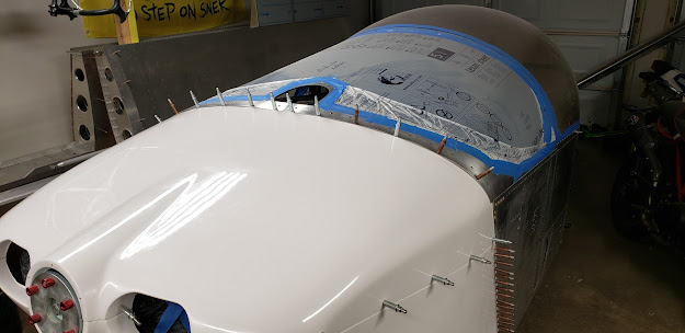

Also, this is much less egregious but I think all stems from the same issue that the windshield skirt is a tiny bit larger than the cowl, but I ended up with a couple small bulges at each corner where it goes around the curved part. I’m not sure what, if anything, I can do about that!

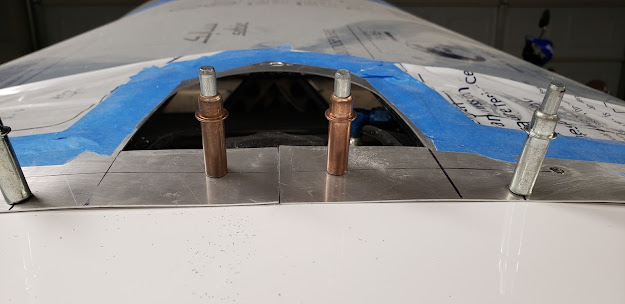

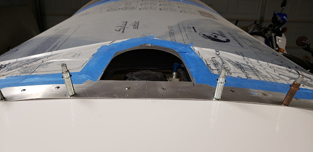

Just to close the loop on this one, here’s what I ended up doing:
I just cut through the little strip of the windshield skirt, right in the center.
Then all I had to do was file a tiny amount of material off of each side (like less than 1/32" I’d say), until the two sides could sit flat next to each other, then I riveted each side to the firewall flange.
That’s it! The little seam is not perfect, but it’s a lot less noticeable than that giant bulge was.
