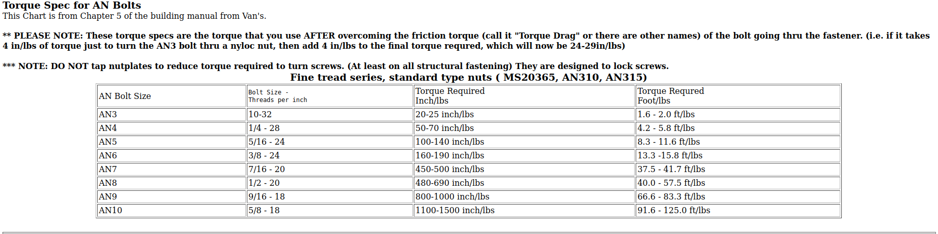

Anybody know the torque value for the 1/4” through-the-firewall motor mount bolts?
Hey welcome to the forum 4redwings!
For those bolts I’d just use nominal AN4 torque values. Here is a picture of a chart:
