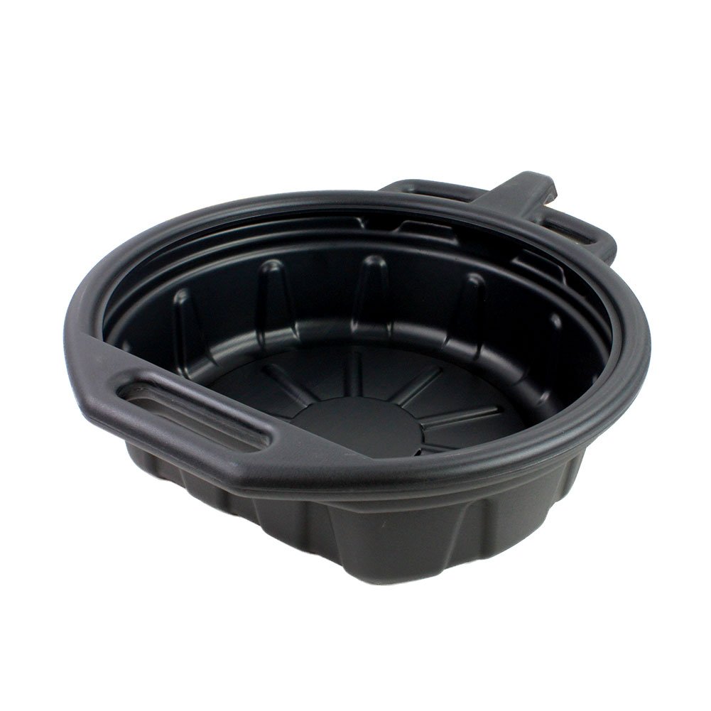

Yep … I’m certain John would agree with that! Another option for those that insist on flying a nose roller might be:
8~)
