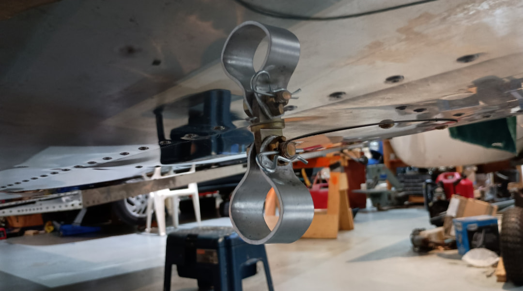

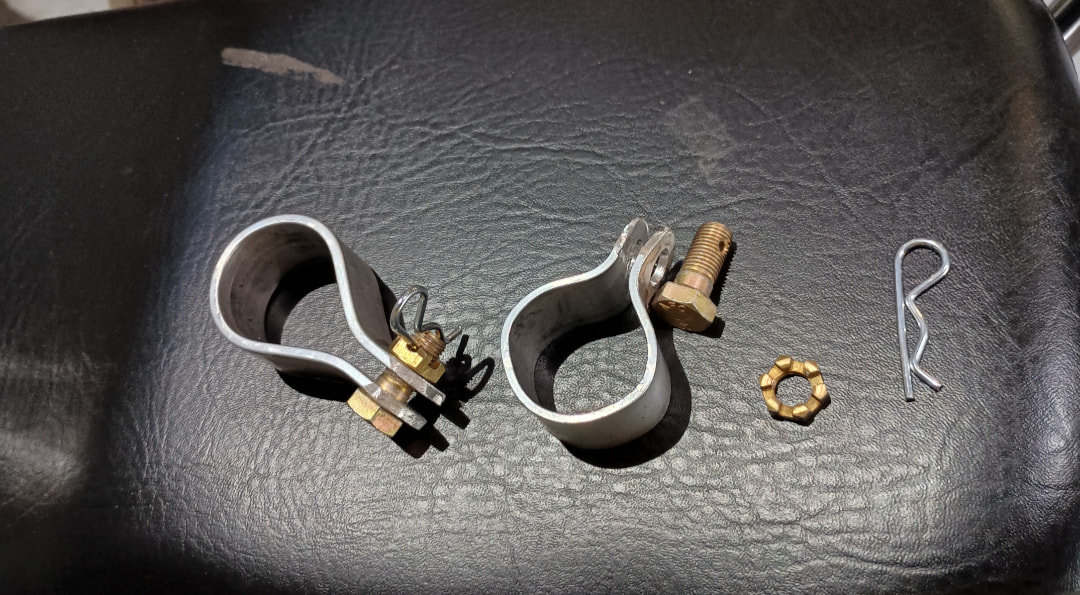

If you have ever flown somewhere and wanted to tie down, you probably discovered the battleship class ropes at the airport don’t fit through the 3/8" tiedown hole very well. So, I made these:
Cheap Amazon 1" wide aluminum, bent around a socket and squashed in a vise. Then drilled to 3/8".
Installs without tools. Weighs about 0.2 lbs for the pair, probably mostly those 3/8" bolts. I might look for aluminum bolts or pins.

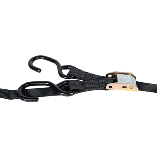

I use something similar to this:
Hook at both ends. One through the wing fixed tie down, the other to whatever is on the ground/floor.

Be careful about the ratchet straps with the open hooks. I have heard quite a few sun n fun / Oshkosh stories about planes bouncing in the wind and those hooks unhooking during the slack part of the bounce.
I have stainless steel shackles from a boating store. Good quality stainless, and got the largest diameter pin that would fit through the tie down hole. Small shackles, don’t weigh much.
Not sure I would trust 1” wide strap of Home Depot aluminum, particularly in an application subject to work hardening.
