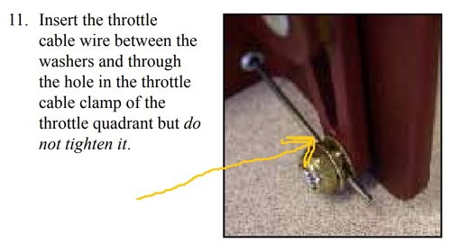

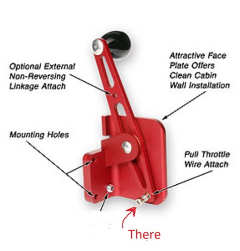

It’s all apart in the aircraft right now - but basically right there against the wire clamp. This is a factory stock picture. Leaving a clean “tail” of wire I could just reach and move back and forth. My wire clamp is a drilled post, two washers and a nylock nut - as described in the AeroInjector Manual Rev D 3/13 Page 10
Break Point
Like here. The post was lubed freely moving in the arm - so I can’t say the wire was being flexed to work harden and break it.
The wire is/was 1x7 wire.
Inspection is tough - because the act of inspecting is as likely to damage the wire. I think I will just go with the solid spring wire option per the manual and replace it every 100 hours or so.

In had it happen twice in a Citabria. Once in flight. It went to full throttle and I used the mixture control to land, pulling it out to glide into a convenient airport. The second time was on the ground while taxiing. It, too is a solid wire cable which can fatigue. It failed in the same place as Graeme’s. You need to keep checking it, and replace it if it looks the slightest fatigued. Pitts has an attachment part that swivels just enough to keep the wire from bending at that point and still open the throttle. I’m not that far along on the Sonex. Does the attach point rotate at all, or must the wire take all of the strain?
Re: Throttle Cable Failure in Flight
Posted: Tue Feb 16, 2021 7:22 pm
Sx1552 wrote:Does the attach point rotate at all, or must the wire take all of the strain?
On the red Aeroconversions throttle - it includes a swivel to reduce chances of fatigue.
