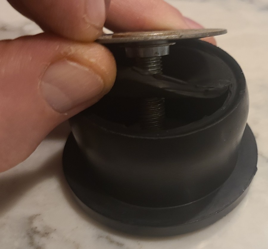

Strong smell of fuel in cockpit after fueling. Traced out whole fuel system from tank through firewall and vent system. No leaks. Was pretty sure I had not over filled and spilled into the dam around the filler and have it ooze into the cockpit. Smell went away after a little. Hmmm…

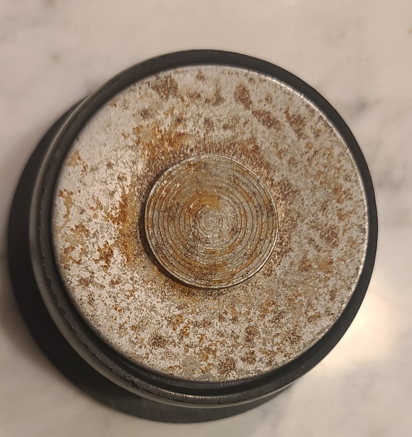

Then I noticed the cap was a little looser when putting in in. Now I am fairly particular about keeping it on the setting and not using the “tighten/loosen” adjustment. But it was loose. Went to dial it tighter. That showed the rubber bung had cracked and failed under the compression plate. That would allow fuel to leak - especially from a full tank.
450 hours in service
Looks Normal
But actually split under the compression plate

One word. Peter Anson. Hmmm. Two words.
Anyway, consider ordering his replacement and put this problem behind you forever.
Gordon

GordonTurner wrote:One word. Peter Anson. Hmmm. Two words.
Gordon
I second Gordon’s remarks. Anson’s fuel tank cap is one of the nicest additions I’ve made to my Sonex. Its well worth the cost.
Re: Thermos Style Pressure Fuel Cap failure
Posted: Fri Feb 11, 2022 9:33 am
My original tank cap started getting too hard to properly seal after a couple of years, replaced and got about same life. Made my own cap similar to Peter’s about the time he came out with his. Now just replace the O-ring every couple of years. Would also recommend getting Peter’s will cost less than repeated purchases of the overgrown wine bottle stoppers.
