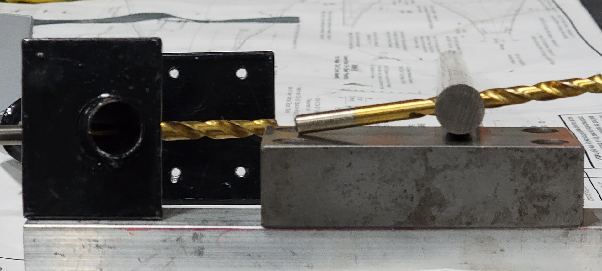

The tailwheel spring and mount on my Sonex was drilled by the original builder. Unfortunately, the hole is off center.
I’m not happy with this. To me it looks like a recipe for failure. I am ordering replacement parts.
I purchased a set of V blocks with clamps for drilling round objects. To drill, I will use an end mill with a diameter no greater than the final hole diameter to make a flat spot to keep the drill bit from wandering off center.
That’s a great idea! I would also have replaced those parts.
It’s a trick I learned from an old German machinist.
