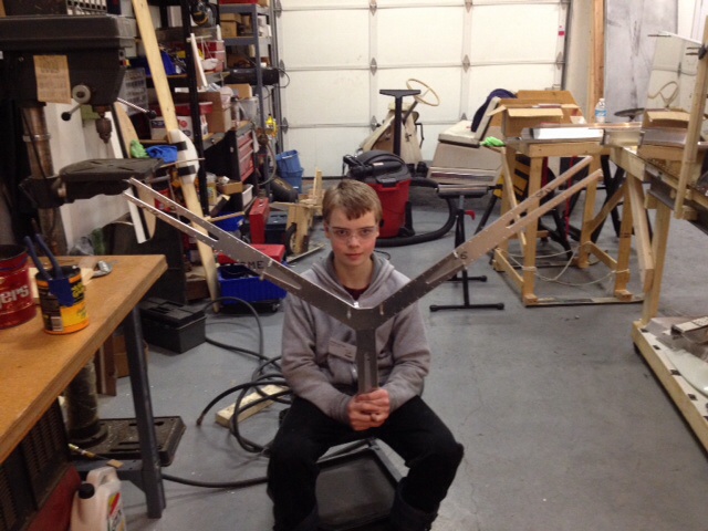

That was a long time ago for me but I don’t think we had the big Y in place when we built the tails.
This next picture was much later:

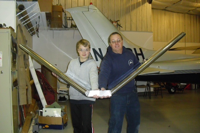

Much later again we clecoed the tail on. I am pretty sure we trusted the holes and all was well. You don’t rivet up the skins until you are drilled, riveted, and deburred.
The sequence should all be in the plans. Worth a study.

Yes, you should proceed with drilling, deburring, hinges, etc. As Brian said, part of the skin does not get riveted until the Y is installed which for me was when the tail was mounted to the fuselage. You leave one side of the skin clecoed so you can debur after drilling the Y to it. I used solid rivets so I was able to buck the rivets that hold on the Y since the skin was open on one side.

My recollection is both the Y and the aft stabilizer channel have predrilled holes. We cleaned up the holes in the Y on the drill press with a #40 bit, and clecoed the parts together. The adjustment of incidence or whatever is done on the front of the tail.
