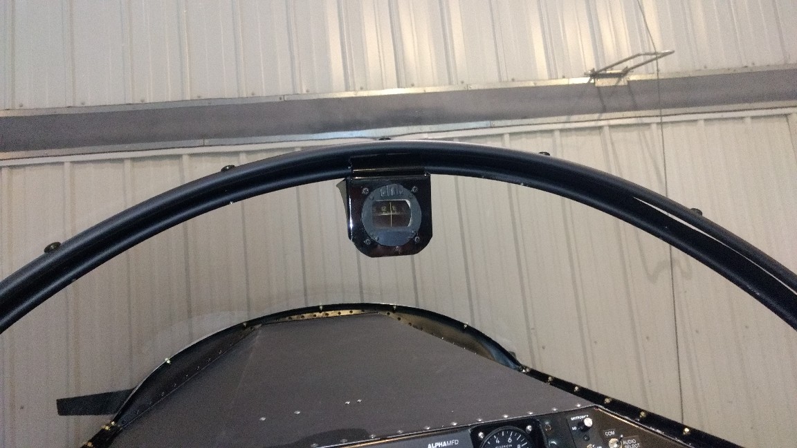

Compass:

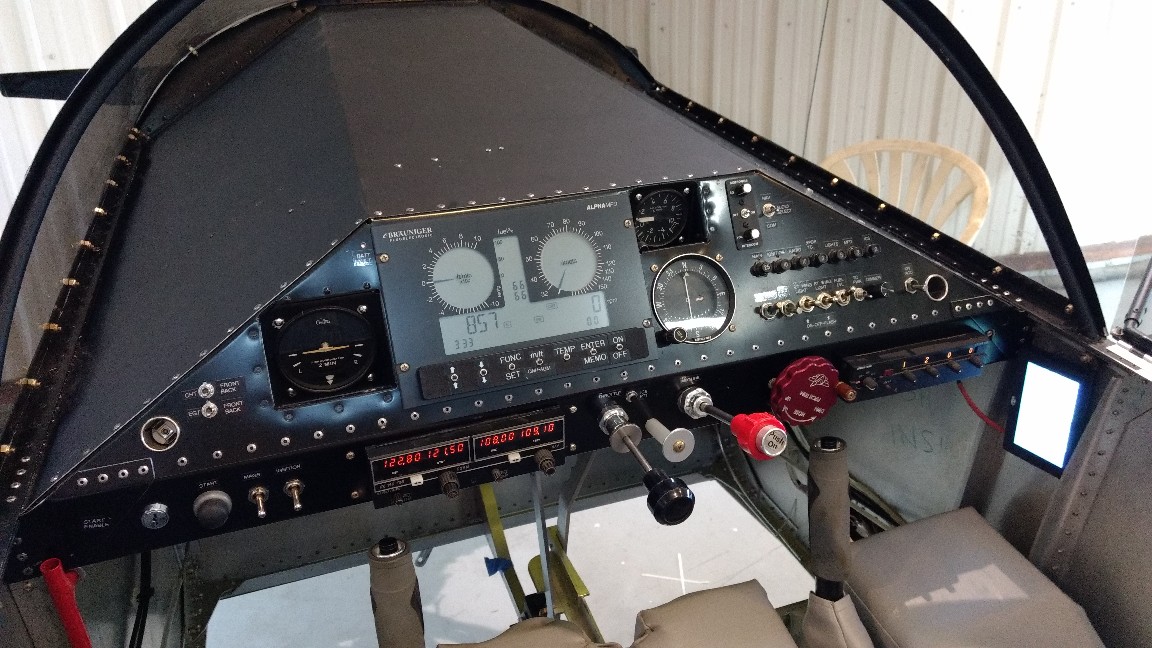

Panel:
The MFD is a Braüniger Alpha MFD. No navigation ability.
Mostly I use my phone or tablet to navigate. I’m looking for a backup.
