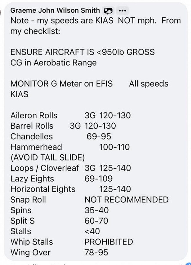

Graeme/others: what speeds do you use for aerobatics? I.e. entry and never exceed speeds for loops, rolls, hammerheads, etc?

Arjay wrote:Graeme/others: what speeds do you use for aerobatics? I.e. entry and never exceed speeds for loops, rolls, hammerheads, etc?
I’ve refined it a little since I posted that. It will Aileron Roll as slow at 70 KIAS - but it is a huge, slow, messy affair! Serious nose up at start and nose down at end. I now tend to do Aileron Rolls at 110KIAS and keep the 120 for when I want to four point it.
Split S - slower is better - cause once inverted and pulling through she will quickly head for VNe. And of you pull too hard - you get an accelerated stall and a lot of mushing downhill.
Please remember - these are for my plane. They may offer guidance for yours - but you need to experiment and find the answers specific to your plane and make the appropriate logbook entries.
