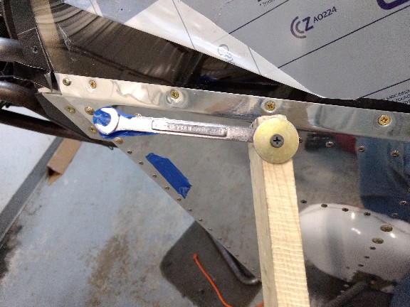

A key tool for the removal and installation was firmly taping a small open end 5/16" wrench to the end of a small dia alum rod (about 30" long). This allows reaching the forward most nuts that hold the windshield to the skirt (of course the Skirt machine screw heads are simply turned with a screwdriver from the outside). I also used a small square of good masking tape (green frog tape) to hold the nuts in place on the wrench end, when reaching inside and centering them on the screws, then just start turning the screw from the outside, and it worked well. I could easily remove the “custom wrench” from the nut after it was tight. For photos and more detail you can check the project on EAA Builder’s Website (zip 79424 - Neil Payne’s project).
