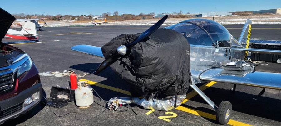

My battery is “tended” by a solar cell on top of my tie down box and always fully charged. Then get it all nice and warm.
A Red Dragon unit. The hose is just flexible dryer vent pipe with an insulated/fiberglass cover (sold for AC duct) over it. Propane for fuel and 12v from the truck for the fan. The blanket is heavily padded. I heat gently from underneath and when the front cylinders are slightly warm to the touch - it starts like a summer day. You just need to be richer on the carb for the low DA.
