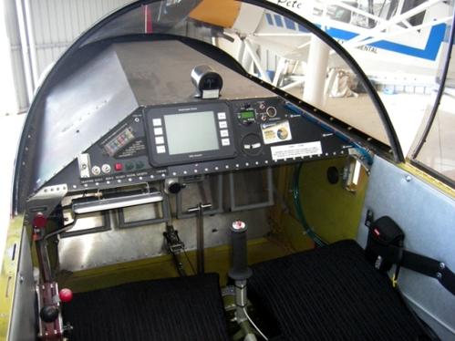

I think I have done what you are suggesting. I bought a Vans throttle quadrant with two levers so used one for throttle and one for trim, but it was tricky to fit. I eventually made so many modifications to it that there is only about 1/3 of the original part left. I don’t have a good photo of it but you can just see the quadrant in the bottom left corner of the pic below.
It works OK but ideally should be a little closer to the panel. The red lever is the trim and it would be better if it was a bit less prominent as I have bumped it on a couple of occasions, in one case making me wonder what I had hit. If I made this part again I would put the trim closest to the side wall.
