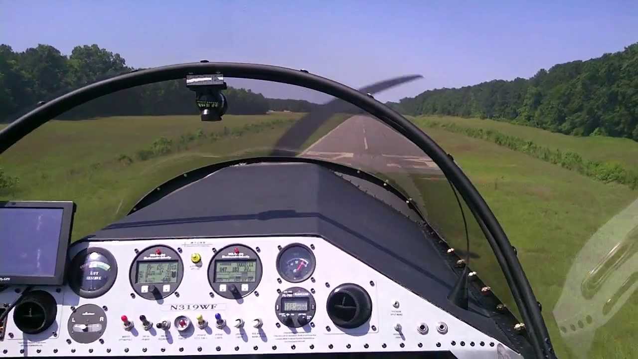

Not quite what you asked about but I installed a mechanical LRI (Lift Reserve Indicator).
It works well and requires no power. I find myself using it more than the ASI when taking off and landing. You can see it here (top left of the panel).
Apologies for the poor video quality.
Hi Dale, not worry about the video, beautyful landing!!! This LRI is something like the one I have in the RANS S7 I’m flying until finish the Sonex. Having no indication about the positioning I think will use the audio alarm from the AV30 I’m installing (alarm activated with critical AoA) going directly to the radio…
