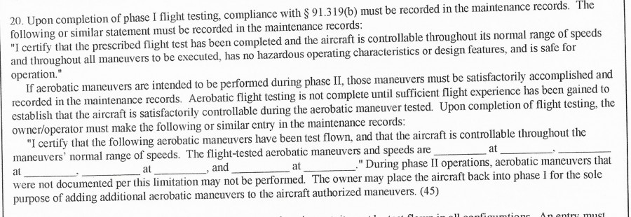

So I was issued new OL’s when I changed my tail number. And while I was at it moved my Phase 1 area from the original builder’s (in SC) to my area in RI.
The inspector from the Boston FSDO commented that these were the “standard template we have been introducing - including the Phase 1 test areas which are worked out already based on your home airport”.
Here is what mine have to say about acro. The middle paragraph is a little unclear - talking about flying acro in Phase II.
But the third para makes it clear that establishing acro maneuvers is done in Phase I (Click on image to see in full)
Re: Spin, engine quit
Posted: Thu Apr 13, 2023 5:27 pm
Going from phase 1 to phase 2 was a logbook entry. What my DAR was saying was you make a logbook entry going back into phase 1, do and document the maneuvers, and you can go back into phase 2. So I think we agree that it is a phase 1 activity - but the disconnect is how we switch phases.
Posted: Thu Apr 13, 2023 5:56 pm
“Put aircraft back into Phase I in order to test XXXXXXXXXX” Date, Signature, Certificate Number.
Posted: Thu Apr 13, 2023 8:17 pm
Yes, although I’m doing:
“Put aircraft back into Phase I in order to expand aerobatic envelope” Date, Signature, Certificate Number.
“XXXXXXXXXX maneuver(s) demonstrated successfully. Put aircraft back into Phase 2.” Date, Signature, Certificate Number.

Posted: Fri Apr 14, 2023 9:54 am
by builderflyer
Graeme, my “OL” look a lot like your “OL” so maybe there is now some consistency across the country and across time. The only other comment I have is that my insurance policy becomes invalid if I place my Sonex back in Phase I, something I hadn’t noticed until after testing four of Prince’s props under Phase I. Don’t know if all policies have that same language but this could be of concern to some.
