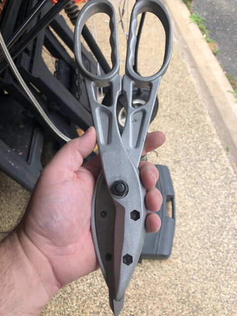

I would appreciate seeing those pics as I to am struggling with the how, where, when questions. I would also like for someone to tell me just how to make a good, nice looking, clean cut through this fairly thick material. Thanks in advance for sharing those pics

I most certainly will share with group and/or PM you if there are too many pictures. Your question is a good one on how to cut through the thick ABS material. I tried in a little corner that will be scrap and the large aluminum cutting aircraft snips cut through it like butter.
