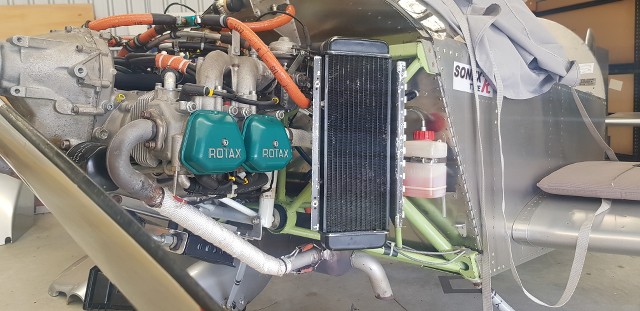

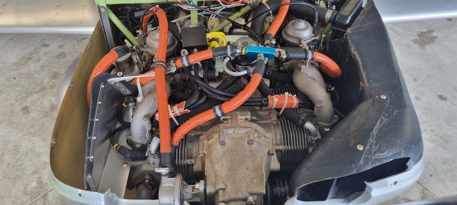

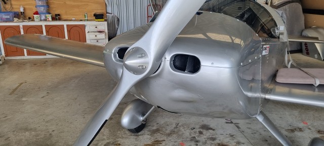

My Rotax powered Sonex cowl, which is the standard horizontal split.
Re: Sonex 912is Install looks CLEAN
Posted: Sat Jan 29, 2022 9:36 am
by bvolcko38
Is this an A or B model? What exhaust did you use? Motor mount? More pics? I am seriously thinking of going with the 912
Posted: Sat Jan 29, 2022 10:06 am
by killerfish72
Gary’s looks like an ‘A’ model. Sonex Inc’s in the video is a B model. I would expect the same cowl on the high wing so any install on a B model from Sonex should be easily re-applied there.
Posted: Sat Jan 29, 2022 4:46 pm
by garyb
A model Sonex standard Rotax round exhaust, I built the mount which is a hybrid of the Aerovee, Jabiru3300 married into the Rotax ring mount. The cowl was opened up for more cooling but after flying it for 180 hours I decided to restore it back to stock as I did not need the extra cooling. Also I like the look of the stock Sonex cowl. As you can see I had to put some bulges on to clear the oil filter and exhaust elbows. The prop is a 68" GT Propeller from a Tecnam P2008 which could do with slightly more pitch. Cruise is 120kts burnning less than 15 litres/h. 5200rpm. Has 190 hours Airframe and 1025 hours on the engine.

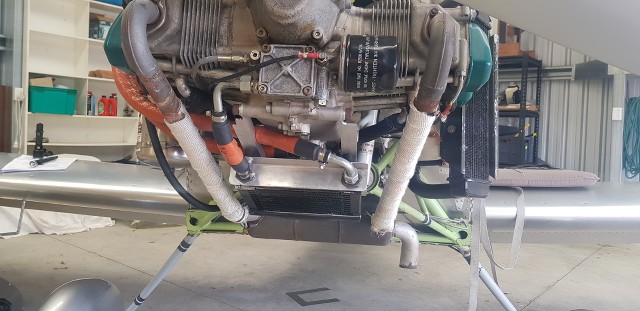

Hi Gary,
I like your oil cooler installation - I am going the same way. Any over/under cooling in this “department”?
If possible, a photo showing your exit air design, would be very helpful.
Your airspeed/fuel consumption is great - hope mine will be similar.
The 2 metal elbow oil lines - Rotax ? or other?

Skippydiesel wrote:Hi Gary,
Hi Skippydiesel
The metal elbows are Rotax, my exhaust sticks about 1/4 inch below the cowl which the aluminum airdam covers up.
In winter I have to tape about 3 rows of the oil cooler to maintain temps. In cruise I see around 90C and up to 110C in a long climb.

I would also be interested in:
Size of oil cooler air intake?
Did you have any problems with purging air from your oil cooler?
The last point - I am contemplating fitting my cooler, same location, but 90 degrees to yours (all fittings on the right side). My thinking is that air purging will be a breeze, cooler body will be just that little bit further from the hot exhaust pipes and I dont anticipate any down side. Your thoughts?
I will look up the Rotax part numbers for the metal oil line connections.

Posted: Tue Feb 01, 2022 3:23 pm
by garyb
Skippydiesel wrote:Gary,
I have found in Rotax parts catalogue, Section 79-20-00, page 9, Oil Radiator;
Part Number 956615 - Screw Connection Set Straight (Correct?)
Part Number 956585 - Screw Connection Set Bent (Correct?)
AND
Is PN 956585 also the fitting on your oil pump?
Hi Skippydiesel
I found a used oil tank and cooler which had all the fittings on and swapped the oil pump and one cooler fitting and they are all the same metric threads, as for the part numbers the IPC I have do not match with your numbers however they are item 11 on page 6 and items 5 and 6 on page 13
