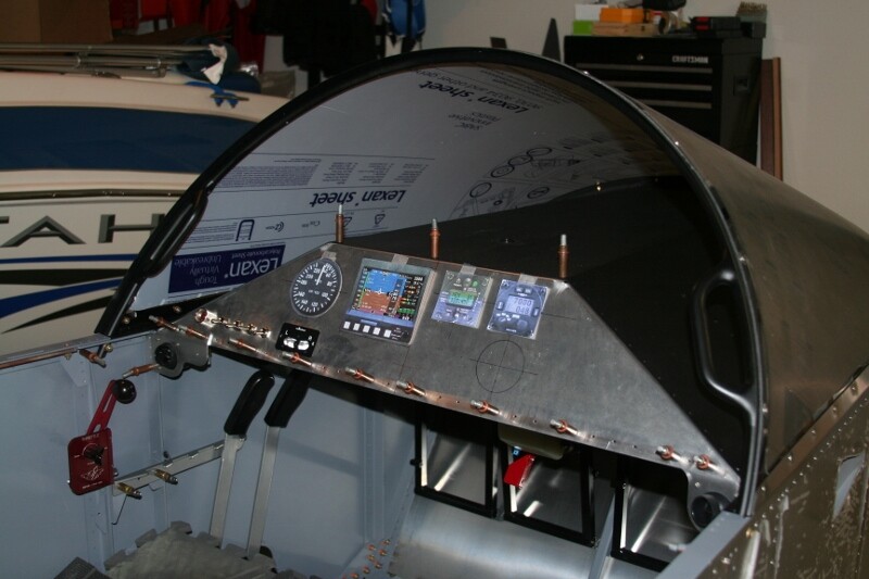

I saw that Mike was working on his panel on the Yahoo forum, so I decided to take advantage of feedback and started to put together my wiring diagram / panel layout. I gathered information from many sources to put this together including the the AeroElectric Z-Diagrams. This is pretty much a basic panel with Overvoltage Protection / Alternator Switch and 3 Annunciator Lights. I welcome any feedback.

Below is a picture of my interior / panel…
Sonex 800 Interior / Panel
Sonex 800 Panel.jpg (232.74 KiB) Viewed 4267 times
