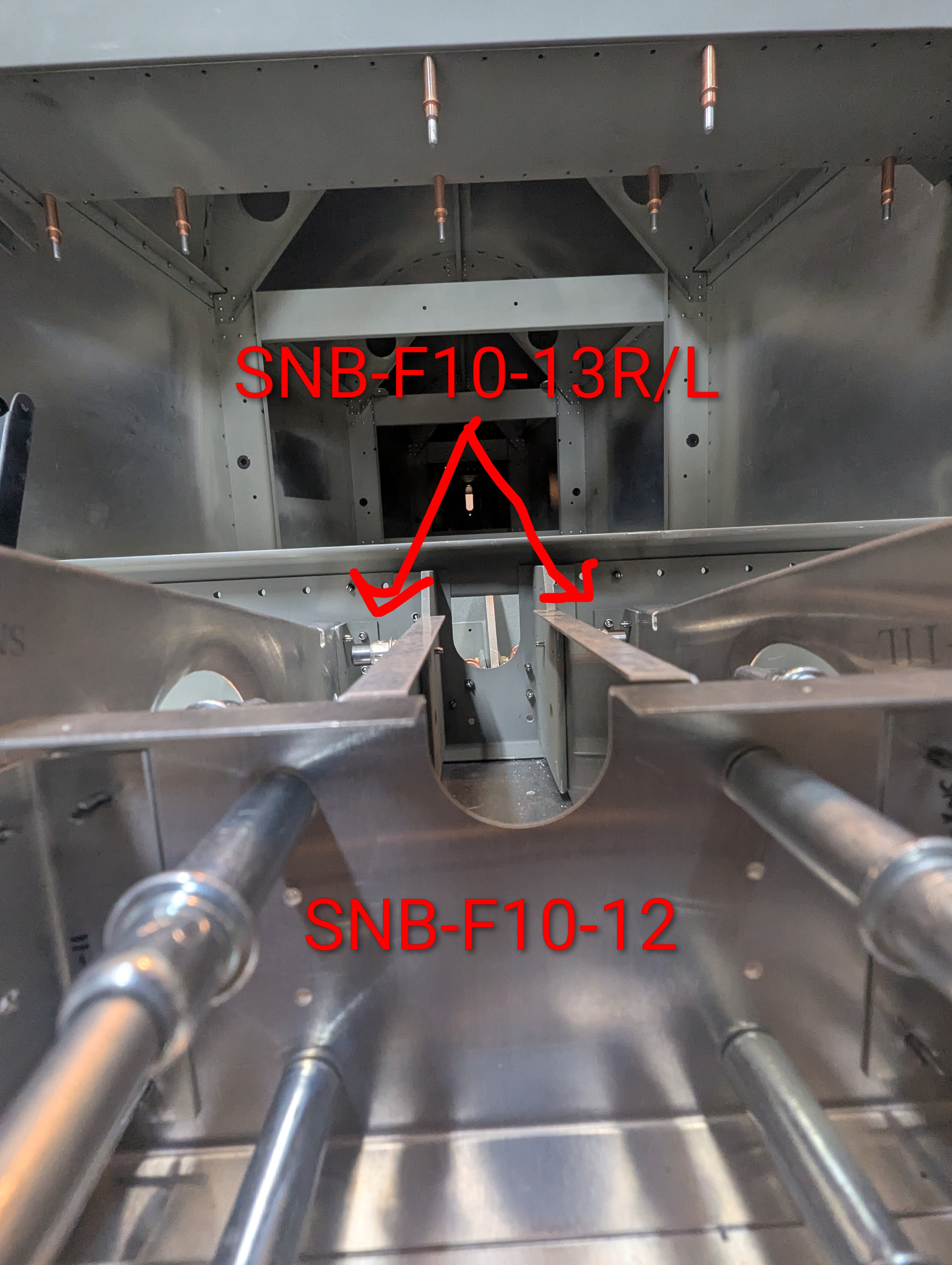

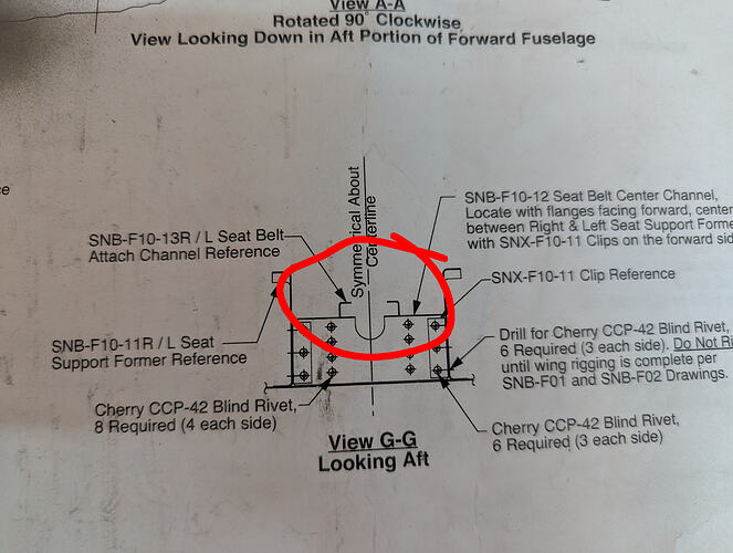

The drawing shows the SNB-F10-13R/L proud of the top of SNB-F10-12:
However, the actual parts are flush in the top:
Am I doing something wrong (e.g. should I move the -13R/L up in the pre-drilled holes, skipping the bottom one)? Or is this just a part where the drawing doesn’t match properly?

Tech support replied quickly. The drawing is incorrect. Mentioning it here in case anyone else is looking for the same question.
